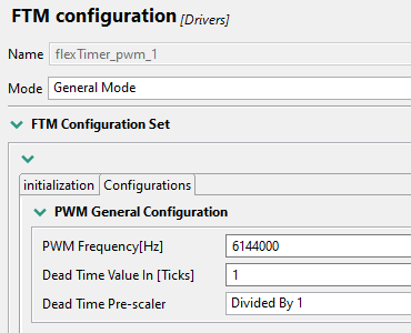

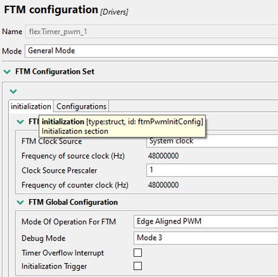

Hello experts,
I am using the S32K342EVB board. In which I am using FTM_PWM for PWM output generation. My Core frequency is 48 Mhz.
I want 6.144MHz frequency but getting 6.87MHz.
below is reference of configuration.
Help me to get required frequency.

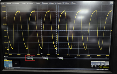

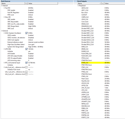

Could you share your clock configurations and an image of your PWM showing the frequency?

Mohit_Manvar
Hi @VaneB
please find screenshots below:
Clock Configuration
Frequency snapshot
Note: I am using S32 design studio for developing pwm freq.

VaneB
Hi @Mohit_Manvar
If you decrease the expected frequency, it has the same behavior?
Also, how are you measuring the signal?

Mohit_Manvar
Hello @VaneB,
Yes, I'm facing same issue on decreasing frequency.
I'm not getting exact frequency as per input.
I'm measuring output via oscilloscope by connecting on Headers of eval board.
