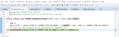

I am using SDK3.0.0 for a LIN communication .
I got a problem when I want to turn off peripherals.
The program is stuck in LIN_DRV_Deinit(INST_LIN1)➡LIN_LPUART_DRV_Deinit(uint32_t instance)➡

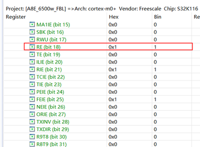

LPUART_SetReceiverCmd(base, false).
The LPUART_CRTL_RE is 1.When I reset it in Debug,program will runnig normally.
This fault occurred sporadically when the mcu powered on.
I have changed the clock source of LIN from SIRC to SOSC,This fault has been resolved.
I want to know the reason about this.
