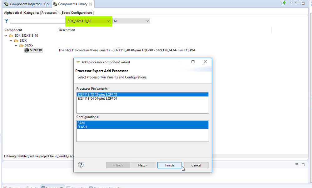

I would use 48 Pins for S32K118, but i only see 64 pins is available , How to select 48 pins package for S32K118?
1,488 Views
jiri_kral
by the same way how you already did it for S32K144 in this thread: https://community.nxp.com/thread/480312
Just change SDK type:
