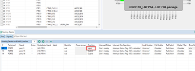

Did you configure that pin as input? For example from the project mentioned above:
Did you call init function like this?
/* Initialize pins */
PINS_DRV_Init(NUM_OF_CONFIGURED_PINS0, g_pin_mux_InitConfigArr0);

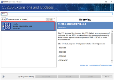

You need to have S32 Design Studio 3.4 installed:
https://www.nxp.com/webapp/swlicensing/sso/downloadSoftware.sp?catid=S32DS-3-4
Then select:
Update the SDK package to version RTM 4.0.2:
And then you will find the example(s) at mentioned folder on c:\ drive.
