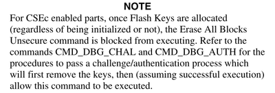

But I got ACCERR(access error) from FLASH_DRV_EraseAllBlock.

cse_flash_part example must be executed from RAM memory as mentioned in the user manual. The goal of this example is to reset the flash back to default state and run partition command to enable Emulated EEPROM and CSEc.
Once the partition command is executed (and CSE is enabled by this command), it's not possible to run the Erase All Blocks command again until the partition is destroyed by CMD_DBG_CHAL and CMD_DBG_AUTH commands:
Most likely, this is the source of problem you have. I guess that you have the cse_flash_part already executed.
To continue with CSE, you do not need to erase the flash again. Just go ahead and use example csec_keyconfig.
If you want to destroy the partition as I mentioned above, run csec_keyconfig again but change ERASE_ALL_KEYS to 1:
#define ERASE_ALL_KEYS 1
You can find this in main.c file.
If the device was already partitioned by someone else, it's necessary to know MASTER_ECU_KEY, otherwise you won't be able to destroy the partition.
