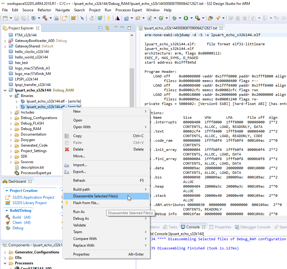

which kind of memory access violation? If you like to see addresses used in .elf file - you can disassembly your .elf file in project. Just right click on .elf file in binaries folder and choose disassembly selected files.
Also the mapfile - located in the Debug folder of your project - project_name.map file is good starting point to look for out of range memory address.
From standard windows command line you can use:
arm-none-eabi-objdump.exe -d your_elf_file.elf
Don't forget add the [S32DS_INSTALL_PATH]\Cross_Tools\gcc-arm-none-eabi-4_9\bin\ into system variable PATH if you like to use objdump across filesystem.

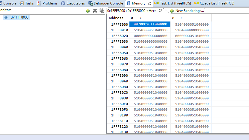

finally - I understand. So, are you able in debug session check if the addresses passed into SDK dma_transfer are valid addresses? You can also check memory content on that particular address in memory view:
But the exception may be caused by bunch of other things - like watchdog, unhandled interrupt and so on. Can you share your project?

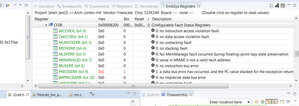

The Exception is a data bus fault.
the variable in question are defined in i2cee.c, i2cee.h and lspi_master_driver.c and it is called "rx_1_buff[35].
if declared as global in "lspi_master_driver.c" everything works if not (defined in i2cee.c/.h) I hit a bus fault.

Also if the error occurs - the Program Counter should hold address of instruction which caused bus error.

I already pinpointed the instruction address.
I LOOKED AT THE STACK AND PC POINTS TO 0X18055 WHICH THIS BEING A THUMB INSTRUCTION SET, ACTUALLY IT MEANS 0X18054 WHICH IS "MOV R3,R0 " AND the following would be "strh r3 [r7, #30] .
I need to dig deeper into this.
