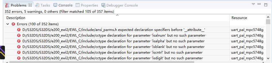

961271210
Actually, I find an AES program which is written by C++, and I want to add it in to S32 project. As you said before, I add the path into include, and there is no problems with head files. But the program has those errors as follows.I wonder if there still are some points I should pay more attention to ?
