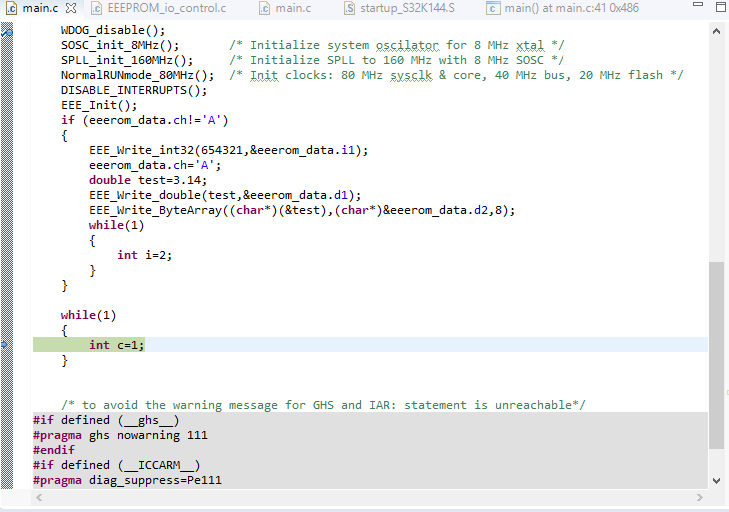

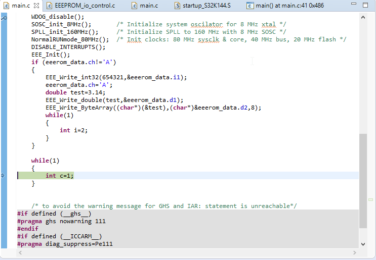

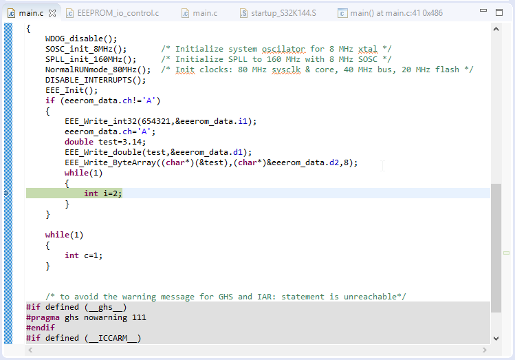

jiri_kral
Hi Bruce,
for me it is working fine (please see attached project). On first run - program ends in first while(1) loop:
after reset ends in second while(1) loop:
Same situation after power cycle when I attach into running program:
1,279 Views
