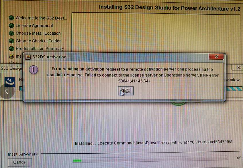

S32DS v1.2 installation problem

I encountered the following problems installing the software, I tried offline and online activation, but failed。I'm sure my network is normal.

could you please try to apply the fix below for correct offline activation behavior?
https://community.nxp.com/docs/DOC-334344
Please let me know, if it works on your side.

Hi ,
Thank you very much, based on your suggestion, I have solved this problem.
