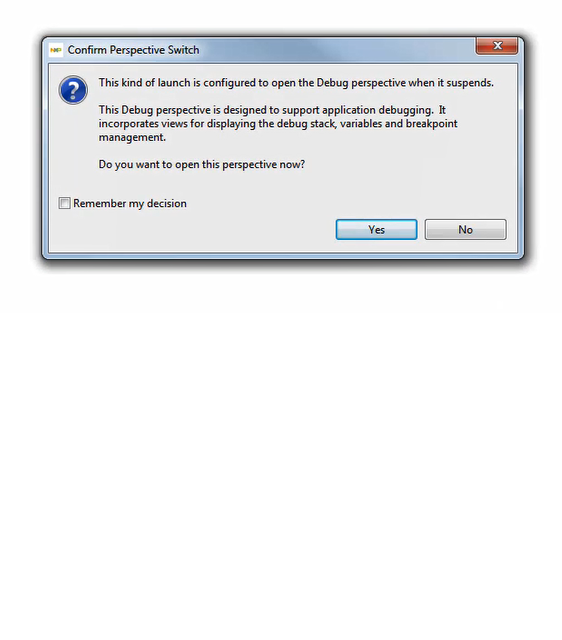

when i debug an Apex2 project using emulator as the "help/resources/S32DS_for_Vision_v2_0_Debug_an_APEX2_Project_using_Emulator.mp4", debug perspective can't be displayed (below pic can't be displayed),
instead of ,there is an error in "Debugger console" as below:

S32DS stopped and can't enter "debugger perspective".

Hello Jian,
This might be caused by missing environment variable path of opencv.
Did you add path for mingw, OpenCV.
path is C:\NXP\S32DS_Vision_v2.0\S32DS\OpenCV\install\x86\mingw\bin in my case.
Put it in the windows environment variables's Path.
Thanks.
