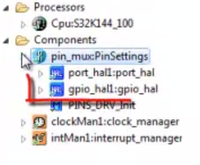

     I create a project follow the video example Blinking LED Recreate Example v2 , and two questions:
1.  The ProcessorExpert.pe have a slash on it. What is mean for slash?
2.The Component pin_mux is different with the video. I don't know why.
Wish for your help!
Thanks!

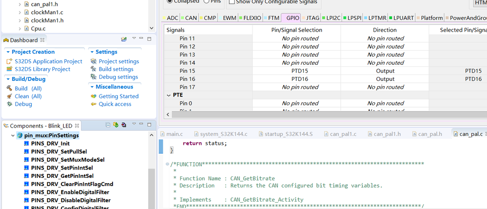

2. This is  the picture in my PC.
and This is picture from vedio:
It's strange that they are different.

mikedoidge
The difference you see between your PC and the video is likely due to the differences in the version of the S32 SDK which was used. The current S32 SDK available for the S32K144 has been updated since the video was recorded. The video will not likely be updated unless there are significant changes in the SDK or IDE which cause it to not be useful.
If you find any content or videos which are no longer useful due to changes in the tools, please inform us so that we might get them updated.
Mike
