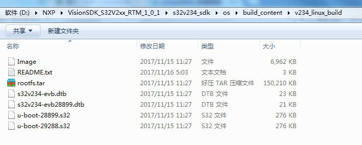

    I had downloaded the Vision SDK RTM1.0.1 and S32DS.Vision 2.0 from NXP.com, I tested that Vision SDK RTM1.0.1 and S32DS.Vision 2.0 could be compatible.

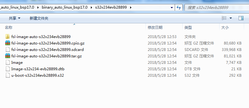

    But I used the Image which was created by the Auto Linux BSP 17.0 of S32V234 as my S32V234evb-28899's linux kernel, and I used the s32v234-evb28899.dtb and rootfs.tar.gz from the Vision SDK RTM1.0.1.
     Unfortunately,I found that the linux kernel of BSP17.0 was not compatible with the dtb and rootfs of VSDK RTM1.0.1. The log had stopped at "Starting kernel ..."
    In addition, I found that the linux kernel of BSP17.0 was compatible with the dtb and rootfs of the latest VSDK RTM1.1.1.
But the lastest VSDK RTM1.1.1 was not compatible with the lastest S32DS.Vision 2.0.
   So,can you tell me which Linux BSP version is compatible with the VSDK RTM1.0.1?   And if possible,can you tell me when we can use the VSDK RTM1.1.1 with the S32.DS.Vision 2.0?

there is linux image present in VSDK installation - s32v234_sdk\os\ . The linux version is BSP 13.0. Next S32DS for vision release will be compatible with BSP 16.0 .
Hope it helps.
Jiri

   Thank you Jiri. Can you tell me how to get the Linux BSP 13.0 from the NXP.com?
1,855件の閲覧回数
zhangweikanghus
   Thank you Jiri. Can you tell me how to get the Linux BSP 13.0 from the NXP.com? I can only get the download link of BSP 17.0.
