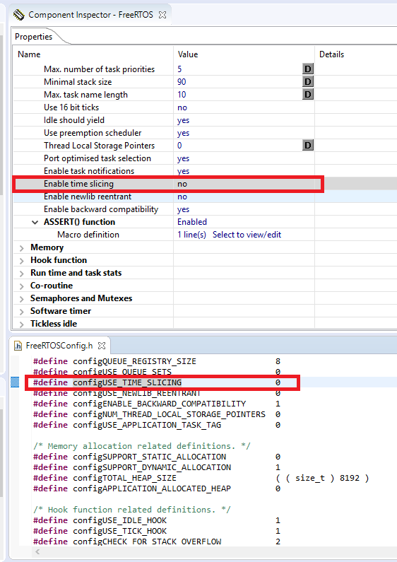

I am using s32 design studio and I have imported a project from examples title 'lwIPs32k148'. My question is want to set the the define configUSE_TIME_SLICING to 0. But, in freertos config file there is no such mention of this macro. Kindly, help me with it.

Hi Saad,

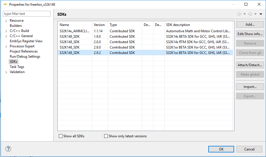

I'm checking this with the latest SDK version (v2.9.2).
You can configure this macro by the property named "Enable time slicing".
"yes"  generates  #define configUSE_TIME_SLICING  1
"no"  generates  #define configUSE_TIME_SLICING  0
if you have some older EAR version of SDK I'd suggest you to update your S32DS to the latest greatest version (https://community.nxp.com/docs/DOC-342194 )
Hope it helps.
