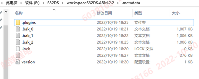

Hi, I am trying to create a project and the "Multiple problems have occured" window appears. How do I solve it?

Hello @dazulong
Please look into your workspace directory and then the subfolder '.metadata'. Inside there should be a file named '.log'. If you can identify this file, please share it to this thread.

dazulong
Hello, mike! No ".log "file found in ".metadata"    —_—
Could it be because my computer is working on encryption?
6,637 Views
mikedoidge
From your image, it looks to me that your system is hiding the '.log' portion of the filename. I think probably the one file that appears to have no name is the .log file.
