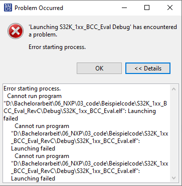

Launching S32_1xx_BCC_Eval has encountered a problem

everytime i try to run the Example code "S32K_1xx_BCC_Eval" the problem you can see in the picture occures.
I already tried to:
1) change from Debug build to Release build
2) change the path of the project
3) looked for breakpoints to remove them (can't find any)
4) run the project while RD33771CNTREVM was connected and disconnected
Nothing worked. The next thing i wanted to try is to reset the RD33771CNTREVM but i don't know how. Has anybody an idea how to solve the Problem?

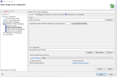

try to remove the C/C++ Application from your Debug configurations (the very first option on the left side).
914 Views
NH97
Thank you for your reply. I'm working with the Universal Multilink Development Interface and this is my debug configuration

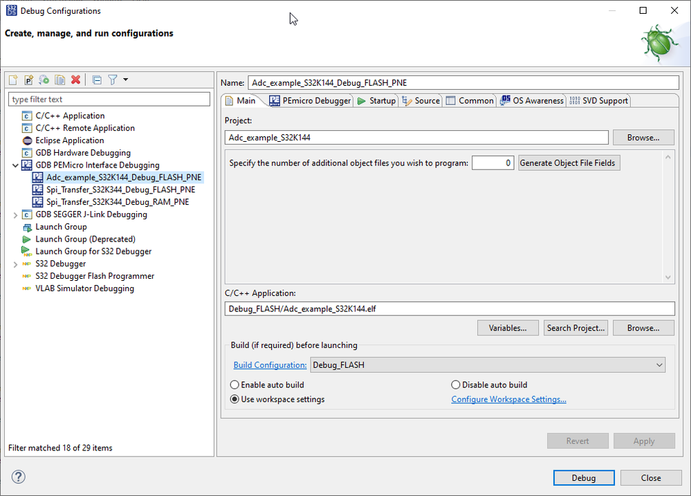

jiri_kral
908 Views
NH97
it seems to be working, Thank you for your help

jiri_kral
from the error message it looks, that you are trying to execute ARM .elf file on your PC Machine. What is your debug configuration and debug probe?
