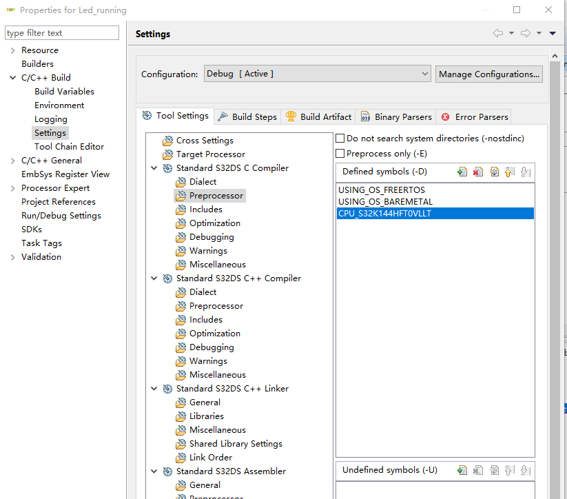

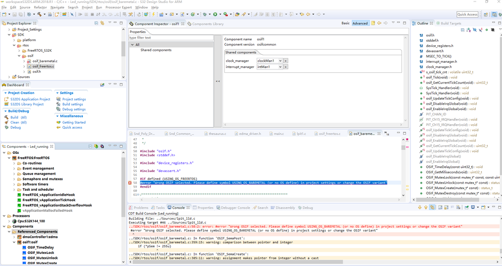

In my project of S32144,
Later I tried to add FreeRTOS, then I compile the project.
In console window, it shows:
../SDK/rtos/osif/osif_baremetal.c:58:2: error: #error "Wrong OSIF selected. Please define symbol USING_OS_BAREMETAL (or no OS define) in project settings or change the OSIF variant"
But I have added the USING_OS_BAREMETAL in project setting.
Why did it happend? What should I do?

I choose use FreeRTOS. Disabled all the code in file osif_baremetal.c , then everthing is fine. I got the effect what I wanted.
