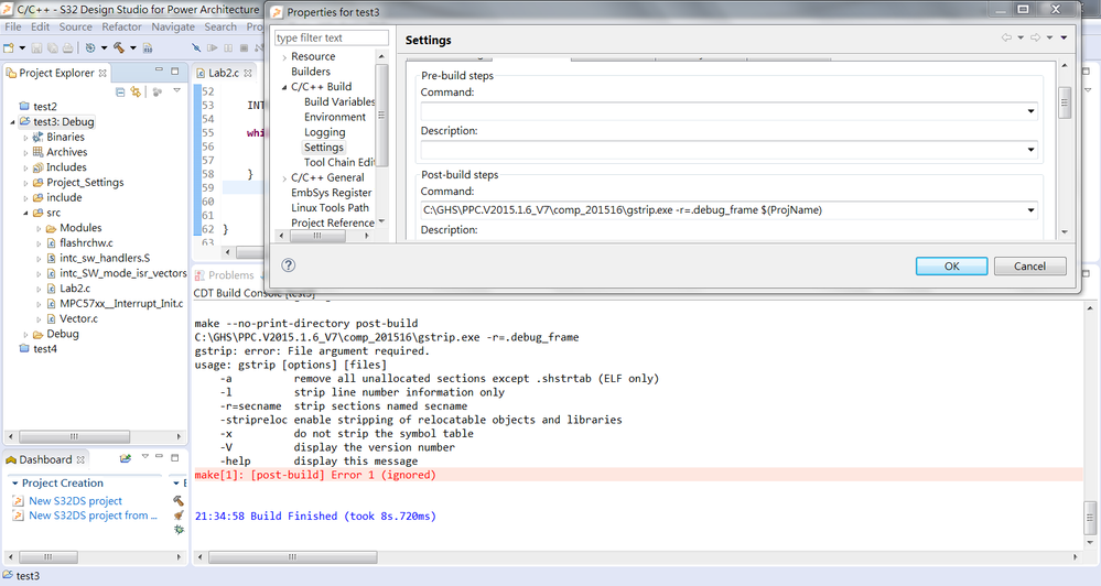

Hi Martin,
I delete .elf, but some problem occurred as follows. Where do I need to set it?
Thanks a lot.
2,268 Views
martin_kovar
delete $(ProjName) from the Command line and insert there absolute path to the .elf file.
