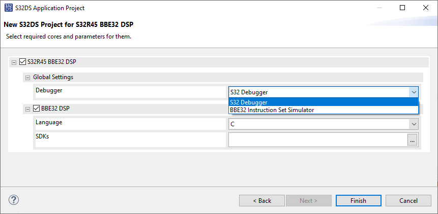

  4. Open existing project or create a new project and check that it successfully builds. If creating a new project, be sure the S32 Debugger is selected in the New Project Wizard.

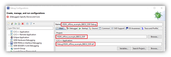

Before a debug session can be started a debug configuration must exist.
Create A New Debug Configuration

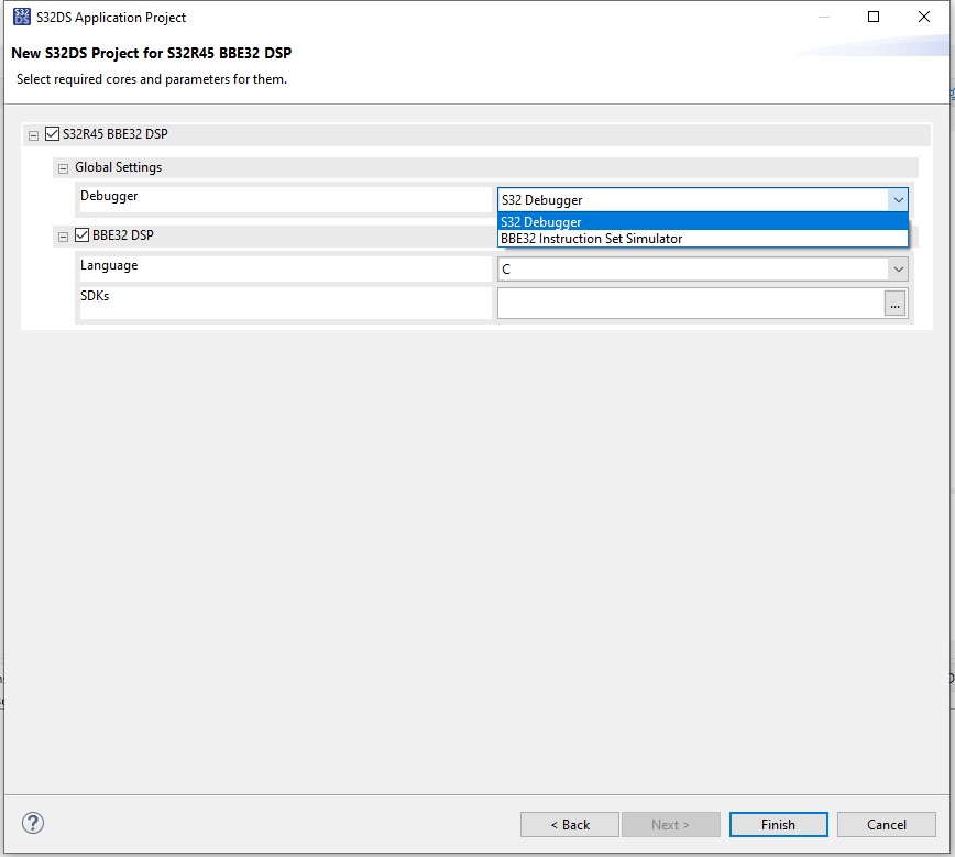

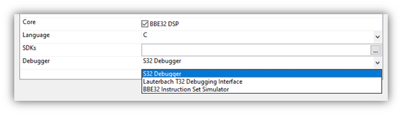

If the New Project Wizard was used to create the project using the S32DS Application Project option, then there was an opportunity to select the desired debugger from within the wizard. If the desired debugger option was selected at this time, then the needed configuration already exists and will only require adjustments to the hardware connection settings.
If the New Project Wizard was not used to create the project OR the currently desired debugger was not the one selected at the time of project creation, a new debug configuration must be created.

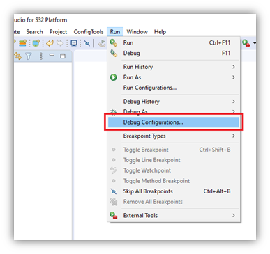

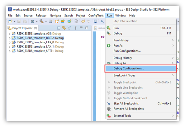

  1. With the existing project selected in Project Explorer, open the Debug Configurations Menu: Run -> Debug Configurations
    Having the existing project selected in the Project Explorer view will make the creation of a new launch configuration easier as many settings will be imported from the selected project. To select a project, click on it so it becomes highlighted.

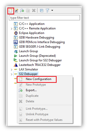

  2. Next, select the debugger for which the new debug configuration will be created.
  3. To create the new configuration, either click on the ‘New launch configuration’ button from the toolbar at the top and to the left, or right-click on the ‘S32 Debugger’ and select ‘New Configuration’ from the menu.
  4. g configuration will contain the project’s name and the Project and C/C++ Application fields will be populated as well. The C/C++ Application field will only be populated if the build output executable exists. Confirm these values are correct before moving on.

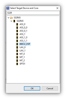

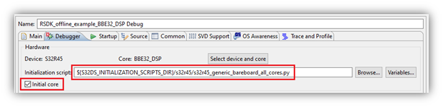

  5. There is an error showing that the Device core ID is not specified on the Debugger tab. Switch to the Debugger tab and click on the button ‘Select device and core’.
  6. From the Select Target Device and Core window, expand the listing until all cores are listed. Notice that all supported cores on the S32R45 are listed. Select the desired BBE32 DSP core and click OK.
  7. Now that the device and core are selected, a generic initialization script associated with the BBE32 DSP is selected automatically, however, this may not be the correct one. If debugging Standalone, meaning only BBE32 DSP core will be debugged, then the automatic selection ‘s32r45_generic_bareboard_all_cores.py’ is correct. This script will initialize all of the cores so the BBE32 DSP can execute properly. If debugging Multicore, meaning both A53 and BBE32 DSP will be debugged, then the A53 and BBE32 DSP cores will already be initialized by the time the debugging on BBE32 DSP begins. So a different script that doesn't initialize all of the cores is needed. Click ‘Browse’ and navigate to ‘{install_dir}\S32DS.3.5\S32DS\tools\S32Debugger\Debugger\scripts\s32r45’ and select the script ‘s32r45_attach.py’. The attach script will allow to start debugging on a core that is already initialized. Refer to the document 'README.txt' located in the same folder as these script files for details on all of the provided scripts.

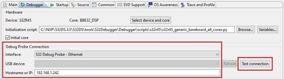

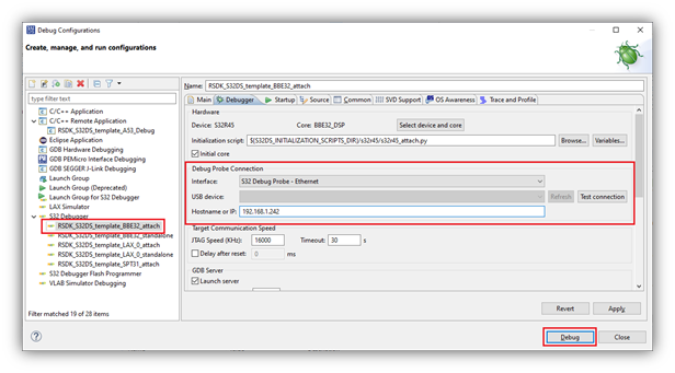

  8. Confirm the setting of the ‘Initial core’ checkbox. This box should be checked within the debug configuration that establishes the first connection to the target device via S32 Debug Probe. When this box is checked, the Debug Probe Connection interface and GDB Server settings become available. The probe connection only needs to be configured once and only one GDB Server needs to be running for each debug session. Therefore, this box should be checked for standalone BBE32 DSP debugging or for multicore debugging where A53 core is debugged via Remote Linux. If the A53 and BBE32 DSP cores are debugged bareboard (no Linux) via the S32 Debug Probe, then this box should be checked for the A53 debug configuration and should not be checked for the BBE32 DSP debug configuration.

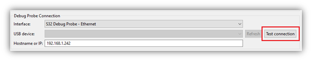

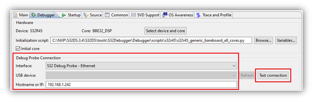

  9. If the initial core box is checked, then setup the Debug Probe Connection. Select either USB or Ethernet, depending upon your hardware setup. If USB is selected, the COM port for the S32 Debug Probe will automatically be detected (unless not connected or more than one probe is connected). If Ethernet is selected, then enter either the hostname (fsl + last 6 digits of MAC address) or IP address. It is highly recommended to press the ‘Test connection’ button to confirm the hardware connection is correctly configured. See the included ‘S32_Debug_Probe_User_Guide.pdf’ for more details on the setup of the S32 Debug Probe.

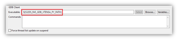

  10. Check that the GDB Client section has the correct path to the BBE32 DSP GDB executable. It should point to the variable ‘S32DS_R45_GDB_XTENSA_PY_PATH’.

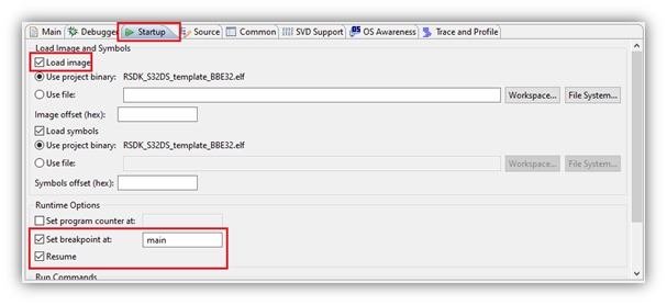

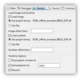

  11. Startup tab check the following settings
    1. Load image is checked for standalone debugging, NOT checked for multicore debugging. Basically, if it is loaded by A53 core (contained in A53 ELF file), then it does not need to be loaded.
    2. Load symbols is checked. The only time you would not check this box is if there is no project binary containing symbols available.
    3. Set breakpoint at main and Resume are checked for standalone debugging, NOT checked for multicore debugging.
  12. Now you are ready to start debugging.

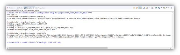

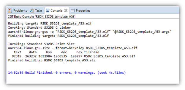

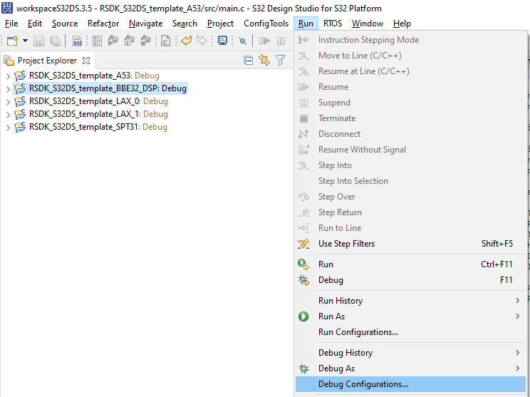

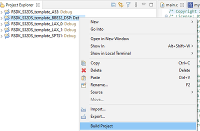

  1. Right-click on the BBE32 project and select Build Project to ensure it builds clean and that the executable exists.
  2. From the menu at the top, select Run -> Debug Configurations…

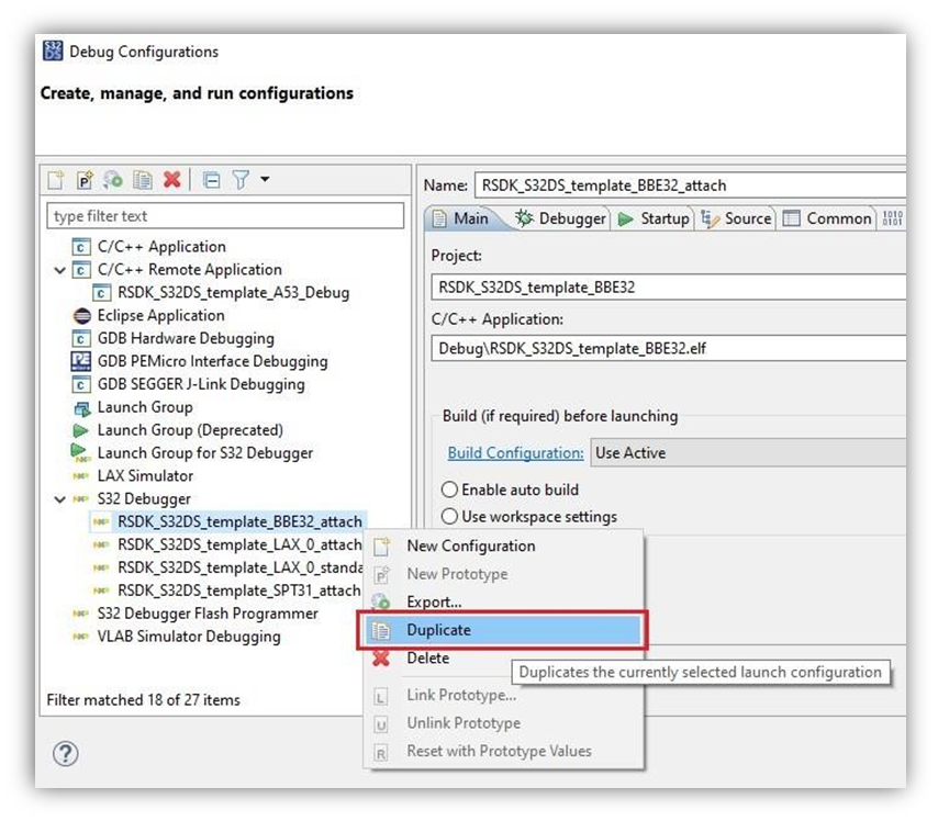

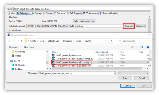

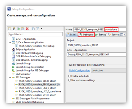

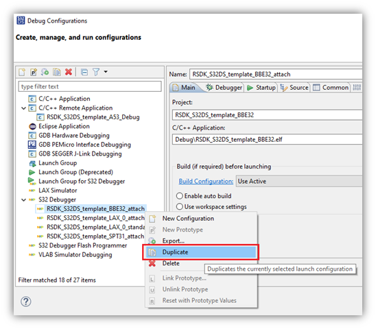

  3. Select the standalone debug configuration for BBE32 core. In the case of the RSDK_S32DS_template example project, only the multi-core debug configuration is supported. In this case, the standalone configuration will need to be created. Right click on the multi-core configuration and select Duplicate. This will create an identical configuration.
  5. Click Browse next to Initialization script and navigate to the directory ‘{install_dir}\S32DS.3.5\S32DS\tools\S32Debugger\Debugger\scripts\s32r45’. Select the script ‘s32r45_generic_bareboard_all_cores.py’.

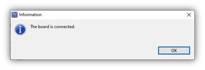

  6. Adjust the Debug Probe Connection settings to match your HW setup. Use the Test connection button to confirm.
  7. Select the Startup tab. For standalone debugging the image file will not be loaded by the A53 core, so it must be loaded by the S32 Debugger. Check the boxes for Load image, Set breakpoint at: and Resume.

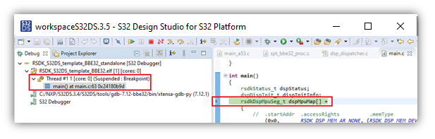

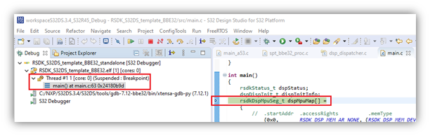

  8. Click Debug to start the debug session. All of the settings made will be applied and the debug session will be launched. The BBE32 will execute to the first line in main().

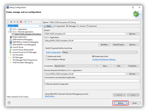

  2. Start A53 debug. From the menu at the top, select Run -> Debug Configurations…

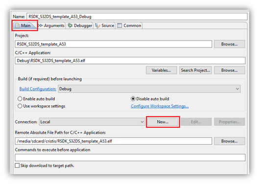

  3. In the Debug Configurations menu, from the configuration list, expand the ‘C/C++ Remote Application’ group and select the ‘RSDK_S32DS_template_A53_Debug’ configuration.

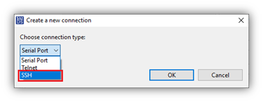

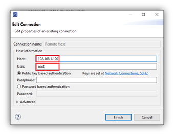

  4. On the Main tab, create a new connection for using the IP address of the EVB. The IP address could be determined either by issuing a Linux command over the serial connection, such as ‘ifconfig’, by accessing the local network connected device list, or perhaps the EVB was setup with a static IP address and it is already known.
    1. Click New… in the Connection section.
    2. Select ‘SSH’ for connection type.
    3. Enter the IP address in Host: field, use ‘root’ in User: field, and leave password field empty.

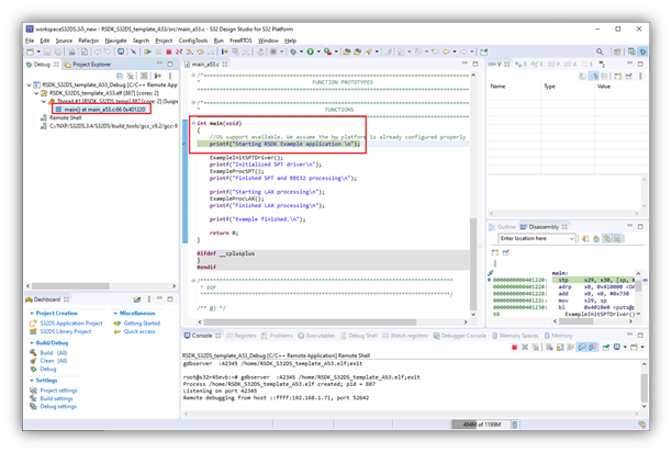

  5. Click Debug to start debugging on the A53 core.
  6. The debugger will launch and execute until the first executable line in main(). See Debugger tab in Debug Configurations menu to adjust this setting.

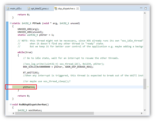

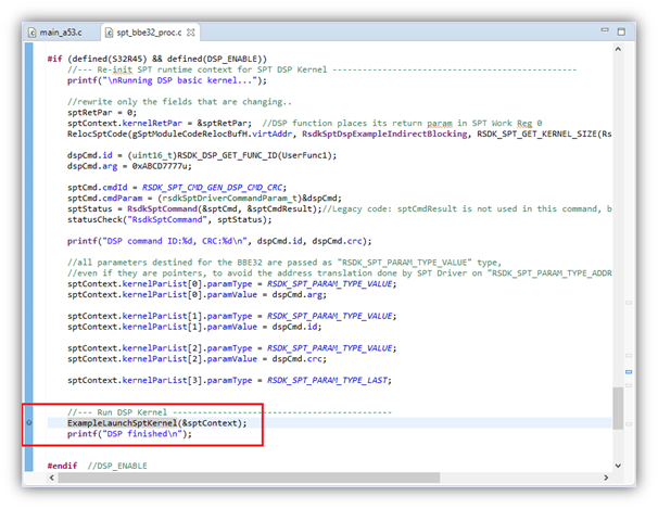

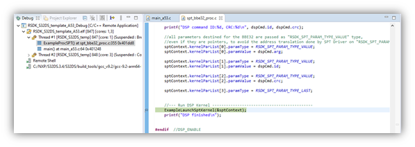

  7. Once the A53 debug session is running, advance the program counter to a line after the desired DSP kernel is loaded to memory but before the DSP kernel is launched. In the example here, this would be in ‘spt_bbe32_proc.c’, line 355, where ‘ExampleLaunchSptKernel()’ function is called. This is best done by setting a breakpoint on the line and clicking Resume.
  8. After the breakpoint is reached, the BBE32 DSP debug session can be started.
  9. Return to the Debug Configurations menu, select the BBE32 DSP debug configuration ‘RSDK_S32DS_template_BBE32_attach’, confirm the Debug Probe Connection settings and click Debug.

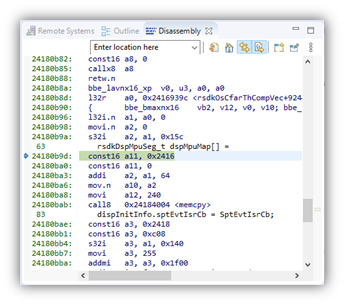

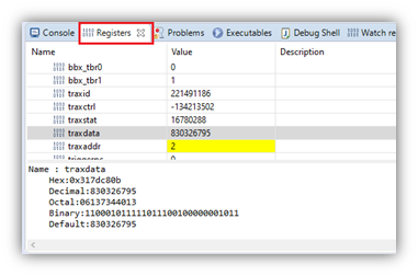

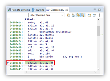

  10. Wait for the BBE32 debug session to launch and stop in the code. Select the BBE32 debug thread to change the context of the Source, Disassembly, Registers and etc.views. Now you can step through the assembly code, access registers, etc.

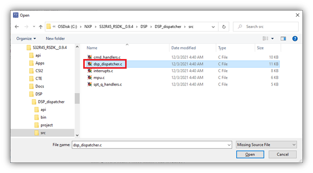

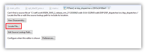

    To see this source code, it may be necessary to locate the file from the RSDK installation folder.
