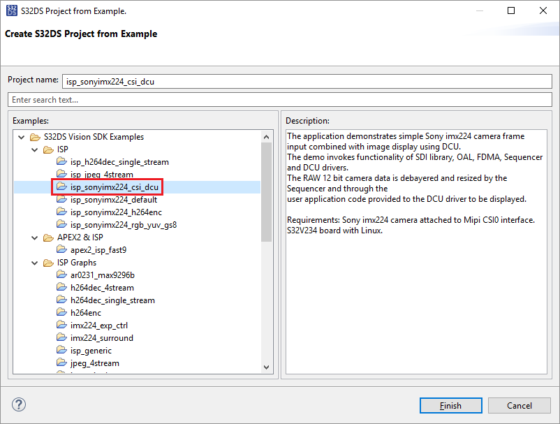

2) Select "New S32DS Project from example"
3) Select isp_sonyimx224_csi_dcu project

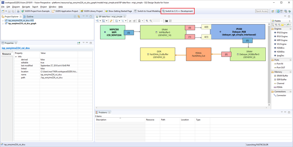

   In this particular project, the ISP graph diagram is included. If you wish to view it, go to the Project Explorer panel and expand 'isp_sonyimx224_csi_dcu_graph'. Then double click on 'ISP data flow : isp_sonyimx224_csi_dcu_graph'. The ISP graph diagram will appear in the editor panel.
4) Change to C/C++ perspective, click on 'Switch to C/C++ Development'

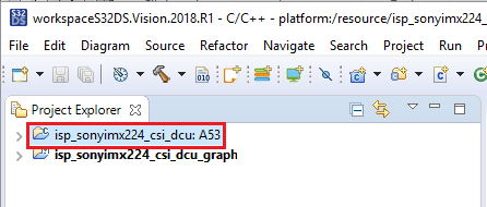

5) Select isp_sonyimx224_csi_dcu: A53 in the Project Explorer panel
6) Build project for A53

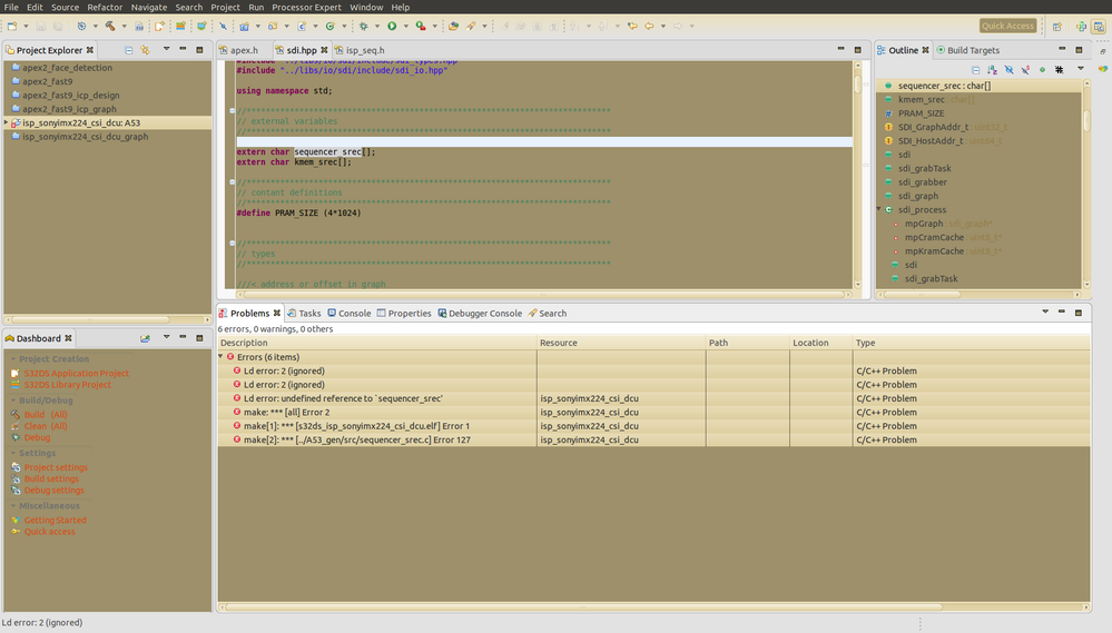

     It is helpful when i follow your guide to create project. But i encounter a strange issue. Could you help me for this? Thanks.
My S32 DS is :S32 Design Studio for Vision Version 2018.R1
PC OS version: ubuntu 14.04 64bits
When i build the project, the logs shown as below:
13:42:02 **** Build of configuration A53 for project isp_sonyimx224_csi_dcu ****
make -j4 all
make --no-print-directory pre-build
rm -f ../A53_gen/src/sequencer_srec.c; make -f ../Project_Settings/Scripts/seq.mk TD="/root/NXP/S32DS_Vision_v2018.R1/eclipse/../Cross_Tools/gcc-6.3-arm32-eabi" VD="/root/NXP/S32DS_Vision_v2018.R1/eclipse/../S32DS/s32v234_sdk"
make[2]: dos2unix: Command not found
make --no-print-directory main-build
Building file: ../A53_src/main.cpp
Invoking: Standard S32DS C++ Compiler
aarch64-linux-gnu-g++ "@A53_src/main.args" -MMD -MP -MF"A53_src/main.d" -MT"A53_src/main.o" -o "A53_src/main.o" "../A53_src/main.cpp"
make[2]: *** [../A53_gen/src/sequencer_srec.c] Error 127
make[1]: [pre-build] Error 2 (ignored)
Building file: ../A53_gen/src/kmem.c
Building file: ../A53_gen/src/mipi_simple.c
Invoking: Standard S32DS C Compiler
aarch64-linux-gnu-gcc "@A53_gen/src/kmem.args" -MMD -MP -MF"A53_gen/src/kmem.d" -MT"A53_gen/src/kmem.o" -o "A53_gen/src/kmem.o" "../A53_gen/src/kmem.c"
aarch64-linux-gnu-gcc "@A53_gen/src/kmem.args" -MMD -MP -MF"A53_gen/src/mipi_simple.d" -MT"A53_gen/src/mipi_simple.o" -o "A53_gen/src/mipi_simple.o" "../A53_gen/src/mipi_simple.c"
Finished building: ../A53_gen/src/kmem.c
Finished building: ../A53_gen/src/mipi_simple.c
Finished building: ../A53_src/main.cpp
Building target: s32ds_isp_sonyimx224_csi_dcu.elf
Invoking: Standard S32DS C++ Linker
aarch64-linux-gnu-g++ -o "s32ds_isp_sonyimx224_csi_dcu.elf" "@s32ds_isp_sonyimx224_csi_dcu.args"
./A53_src/main.o: In function `LibsPrepare(AppContext&)':
/root/workspaceS32DS.Vision.2018.R1/isp_sonyimx224_csi_dcu/isp_sonyimx224_csi_dcu/A53/../A53_src/main.cpp:298: undefined reference to `sequencer_srec'
collect2: error: ld returned 1 exit status
make[1]: *** [s32ds_isp_sonyimx224_csi_dcu.elf] Error 1
make: *** [all] Error 2
13:42:07 Build Finished (took 4s.477ms)
Description Resource Path Location Type
Ld error: 2 (ignored) C/C++ Problem
Ld error: undefined reference to `sequencer_srec' isp_sonyimx224_csi_dcu C/C++ Problem
make: *** [all] Error 2 isp_sonyimx224_csi_dcu C/C++ Problem
make[1]: *** [s32ds_isp_sonyimx224_csi_dcu.elf] Error 1 isp_sonyimx224_csi_dcu C/C++ Problem
make[2]: *** [../A53_gen/src/sequencer_srec.c] Error 127 isp_sonyimx224_csi_dcu C/C++ Problem
are you able build ISP target?
If not, please share the output from build console.
