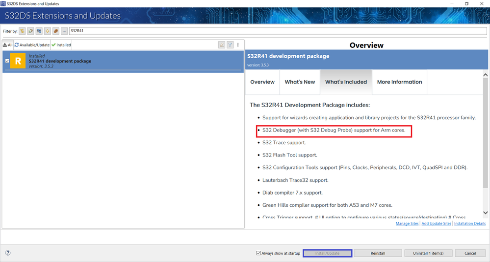

  1. Setup the software tools
    1. Install S32 Design Studio for S32 Platform
    2. Install the Development Package for the device you are debugging. In this case, the S32R41 development package. This package is important as the S32 Debugger support component contains the device-specific Python scripts required for initialization of the cores.

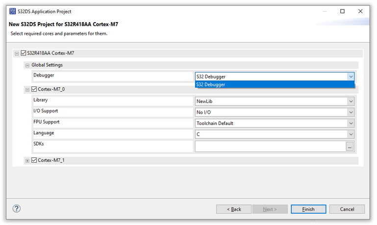

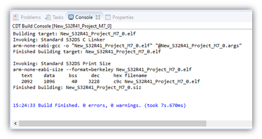

  4. Create new or open existing project and check that it successfully builds. If creating a new project, be sure the S32 Debugger is selected in the New Project Wizard

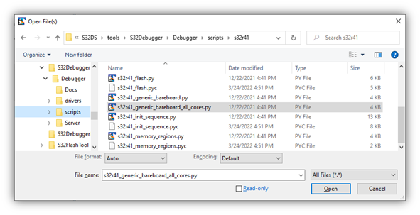

  1. Prepare the initialization script for the core(s) to be debugged.
    1. Open the core initialization Python script:
      {S32DS Install Path}\S32DS\tools\S32Debugger\Debugger\scripts\s32r41\s32r41_generic_bareboard_all_cores.py

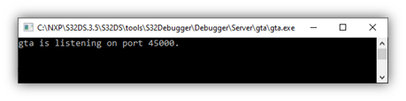

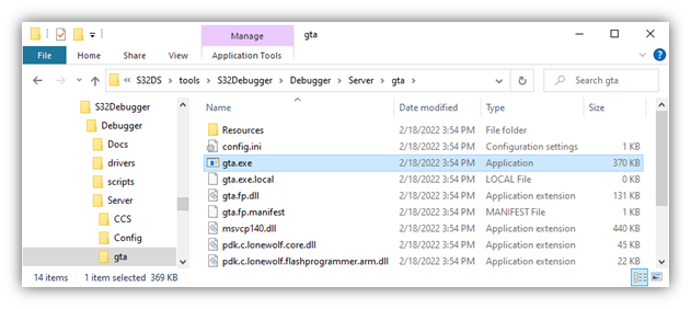

  2. Launch GTA server. From command prompt or Windows File Explorer run the command:
    {S32DS Install Path}\S32DS\tools\S32Debugger\Debugger\Server\gta\gta.exe
    Should see a window appear like this:

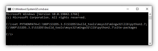

  3. Ensure Environment Variable for Python is set. From command prompt, run the command:
    set PYTHONPATH={S32DS Install Path}\S32DS\build_tools\msys32\mingw32\lib\python2.7;{S32DS Install Path}\S32DS\build_tools\msys32\mingw32\lib\python2.7\site-packages

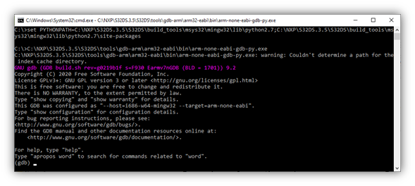

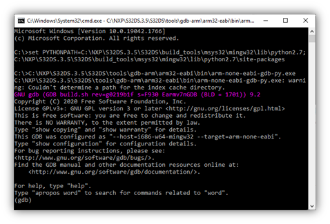

  4. Start GDB. In a command window, run the command:
    Windows OS:
    {S32DS Install Path}\S32DS\tools\gdb-arm\arm32-eabi\bin\arm-none-eabi-gdb-py.exe (for arm32)
    OR
    {S32DS Install Path}\S32DS\tools\gdb-arm\arm64-eabi\bin\aarch64-none-elf-gdb-py.exe (for arm64)
    Linux OS: arm-none-eabi-gdb-py
    A (gdb) prompt should now be displayed in the command window:

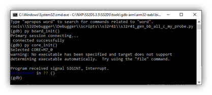

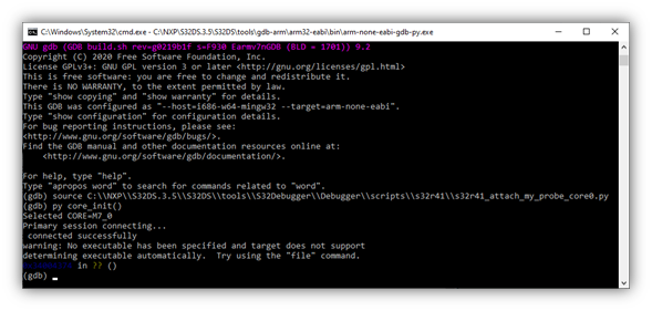

  5. From (gdb) prompt, enter the following commands(in this order):
    1. source {S32DS Install Path}\\S32DS\\tools\\S32Debugger\\Debugger\\scripts\\s32r41\\s32r41_gen_bb_all_c_my_probe.py
      This specifies the script for initialization.
    2. py board_init()
      This initializes the board. It should only be called for the initial core. In a multicore debugging workflow, the debugger launch for additional cores would omit this step.
    3. py core_init()
      This initializes the core specified in the initialization script in step 1.

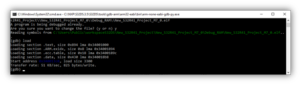

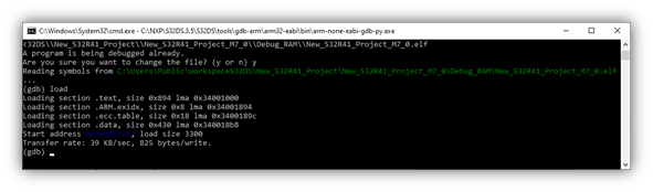

  6. Now standard GDB commands may be used. For example, you may wish to load an ELF file:
    1. file {S32DS Workspace Path}\\New_S32R_Project_M7_0\\Debug_RAM\\New_S32R_Project_M7_0.elf
    2. load

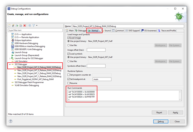

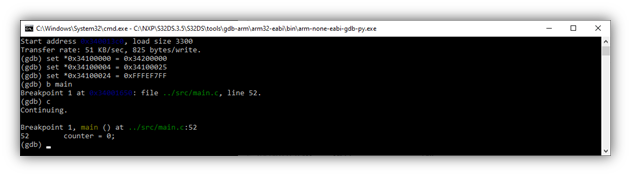

  1. Some additional steps will need to be performed from within the primary core GDB session, enter the following commands:
    set *0x34100000 = 0x34200000
    set *0x34100004 = 0x34100025
    set *0x34100024 = 0xFFFEF7FF
    b main
    c
    These lines prepare the environment for launching debugging on secondary cores. This will allow for multicore debugging in the case of separate ELF files for each core. These can be found in the Run Commands field of the Startup tab on the Debug Configuration for the primary core within S32 Design Studio IDE, of any multicore project created from the New Application Project Wizard. Note: If there is just one ELF file for all cores, then these 'set *0x... = 0x...' commands should be skipped.
    In general, it will be correct to set the break-point at main, as shown, but this might need to be changed depending on when the secondary cores are started within the project.

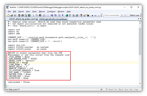

  2. Prepare the initialization script for the secondary core to be debugged.

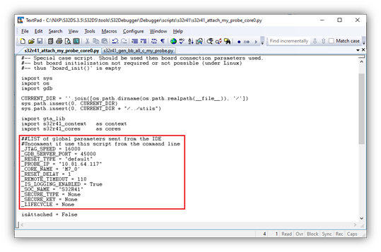

      {S32DS Install Path}\S32DS\tools\S32Debugger\Debugger\scripts\s32r41\s32r41_attach.py
      This is a different script than the one used for the primary core. It is designed to launch a debug session on a core which is already initialized and running.
    2. Edit the script for the secondary core to be debugged. Since this script is setup for the primary core, some adjustments need to be made to setup for a secondary core
      1. Uncomment the following lines:
        # _JTAG_SPEED = 16000
        # _GDB_SERVER_PORT = 45000
        # _RESET_TYPE = "default"
        # _PROBE_IP = "s32dbg"
        # _CORE_NAME = 'M7_0'
        # _RESET_DELAY = 1
        # _REMOTE_TIMEOUT = 110
        # _IS_LOGGING_ENABLED = False
        # _SOC_NAME = "S32R41"
      2. Make the following changes to the lines:
        _JTAG_SPEED = 16000 ->  None
        _PROBE_IP = "s32dbg" -> None
        _CORE_NAME = 'M7_0' -> 'M7_1' (this should be set to match the name of the core to be debugged, see s32r41_context.py for complete list)
        _RESET_DELAY = 1
        _IS_LOGGING_ENABLED = False -> ‘True’
    3. Save the file with a new name to preserve the original. For example, s32r41_attach_my_probe_core1.py. This ensures the S32 Debugger will still function correctly.

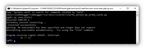

  5. From (gdb) prompt, enter the following commands (in this order):
    1. source {S32DS Install Path}\\S32DS\\tools\\S32Debugger\\Debugger\\scripts\\s32r41\\s32r41_attach_my_probe_core1.py
    2. We will not execute the py board_init() as this was already done for the primary core.
    3. py core_init()
      This initializes the core specified in the initialization script in step 2.
