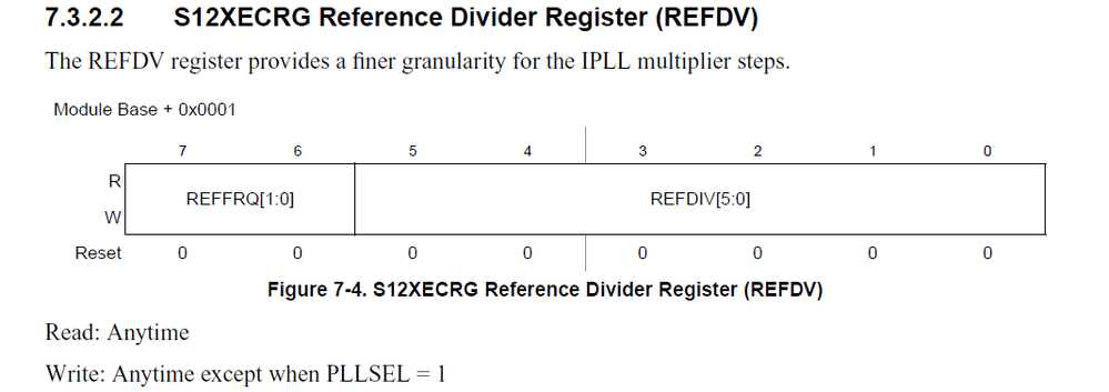

for example, i write code like this:
REFDV = 0x01;
so i expected that REFDIV0 = 1
but when i run this code(using Trace32)
(before)
(after)
the REFFRQ1 became 1, seems like reversed when writing.
And it have the same problem in reading. If i want to read bit3( REGISTER_BIT3), have to use the bit4( REGISTER_BIT4)....
(though the REFDV.Byte=1 in the watch)
 And i'm very confuse about this.
So if anyone have ideas?
If it is problem with bit order or something else?

I thought about Endian. But changing Endian is changing byte order, right? My problem is the bit order, and i think that it may be some settings related to compiler or debugger(TRACE32)

kimchan_eb
The problem has been solved.
I use "watch" to watch the every bit of register like the picture in my question. and i found that it's "incorrect". But I tried to use "peripherals" to watch the register. It shows the value of register as we think. And I have corrected my code using "peripherals".
Also thanks to Lauterbach support that they told me try using it.
