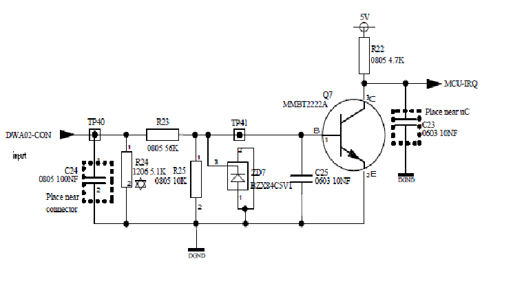

hi,
i am using Mc9s12xEQ512, micro hsc12 compiler.
i am facing an issue with IRQ interrupt wake up, i am using three other wake ups, XIRQ and 2 kwp wakeup, i am not having any issue, but when i am waking up the system with IRQ interrupt, the system is Resetting instead of wake up,
i am writting the details about the initalization and code flow for sleep and wake up
Vector table location showing the Address for IRQ
    UnimplementedISR,                 /* 0xFFE0 Enhanced Capture Timer channel 7 */
        UnimplementedISR,                 /* 0xFFE2 Enhanced Capture Timer channel 6 */
        UnimplementedISR,                 /* 0xFFE4 Enhanced Capture Timer channel 5 */
        UnimplementedISR,                 /* 0xFFE6 Enhanced Capture Timer channel 4 */
        UnimplementedISR,                 /* 0xFFE8 Enhanced Capture Timer channel 3 */
        ECTCH2_ISR_Read_PlsInput,                 /* 0xFFEA Enhanced Capture Timer channel 2 */
        ECTCH1_ISR_Read_PlsInput,                 /* 0xFFEC Enhanced Capture Timer channel 1 */
        ECTCH0_ISR_Read_PlsInput,         /* 0xFFEE Enhanced Capture Timer channel 0 */
        UnimplementedISR,                 /* 0xFFF0 Real Time Interrupt */
        IRQ_ISR,                 /* 0xFFF2 IRQ */
        XIRQ_ISR,
        UnimplementedISR,                 /* 0xFFF6 SWI */
        UnimplementedISR,                 /* 0xFFF8 Unimplemented instruction trap */
        UnimplementedISR,                   /* 0xFFFA COP failure reset */
        UnimplementedISR,                  /* 0xFFFC Clock monitor fail reset */

Code involving the sleep and wake up
void Init_Wakeup_modules(void){
  IRQCR.byte = 0xC0;      //IRQ pin is connected to interrupt logic, interrupt is
                           //triggered on fallinge edge
  PPSP.byte =  0x01;       //Select active high interrupt for Parking lamp and active low interrupt for Door open
  PIEP.byte =  0x03;       //Enable KWP0 and KWP1 wakeup interrupts
/* This function checks for the sleep and wakeup control inputs, if not available controller is forced to STOP mode */
void DisableWakeupIntr(void){
  IRQCR.byte = 0;         //Disable external interrupts
  PIEP.byte = 0x00;       //Disable KWP0 and KWP1 wakeup interrupts
  Init_WakeUp();
  Wkup_Int_Disabled = 1;
void EnableSleep(void){
    Init_Wakeup_modules();
    Wkup_Int_Disabled = 0;
//--------------------------Port pins disables for power down operation-----------------------
    SPI0.spicr1.bit.spe = 0;
    SPI1.spicr1.bit.spe = 0;
    IIC0.ibcr.bit.iben = 0;
    Dig_OP_Init();
    Test2_SWsupply(0);
    asm ANDCC #0x6F;  //clear S bit - enable the stop mode. If the S bit is not
                      //cleared then STOP instruction has no effect and is
                      //executed as a dummy instruction NOP.
                  asm STOP;         //Invoke the Stop mode
                  Wakeup_Init();
                  //_Startup();       //Go to startup
                  //Wakeup_Init();      // do only init variable which is required after sleep
    // commented to test the issue of no wakeup after sleep
//IRQ_ISR
#ifdef __MWERKS__
#pragma TRAP_PROC
#else
static @interrupt @near
#endif
interrupt void IRQ_ISR(void)
//-------------------------interrupt
i have also attached the power module of my micro and circuitry involving the IRQ for your REF.
2,916 Views
satishperumal
in my previous post , the IRQ _SChematics is not clearly visible, please find the attached IRQ schematics,
