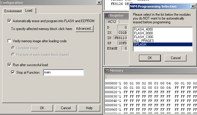

Hello eveybody,
How can I program S12G without erasing data in EEPROM. I think there is a setting in CW but I cannot find where.
Thank you in advance
2,414 Views
RadekS
Hi Claudio,
In CW debugger (hiwave.exe) menu – File – Configuration – Load tab – Advanced – mark EEPROM (blue background).
Note: Screenshot was captured for different MCU.
After next loading code, EEPROM programming will be skipped.
I hope it helps you.

kef2
Senior Contributor V
Don't have S12G at hand, but with minimal or none mods save/restore trick should work:
S12X flash memory copy
If not, try searching for flash save / restore and/or "AEFSKIPERASING" command.
