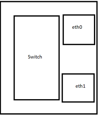

The procedure that you are trying is correct when you have a physical switch layer.
The iMX8MP EVK has two independent Ethernet ports and doesn't have a switch layer between the ports.
I think is possible to do a bridge layer with software, but we don't have the program or examples.
I have tried the commands that are you using and if you are connecting with the board using ssh the communication hangs because the board is trying to connect the ethernet ports, but if you connect the board via USB doesn't hangs for ethernet configurations first use the debug port and then you can use the ssh server to connect the board.

Chavira
Hi @magnus3 !
If you want to use the evk you have to implement the switch layer with software, if you are developing a custom board, I recommend reviewing the Layerscape Reference Design Boards, you can find a compatible part to iMX8MP and do the switch layer via hardware without complications.
