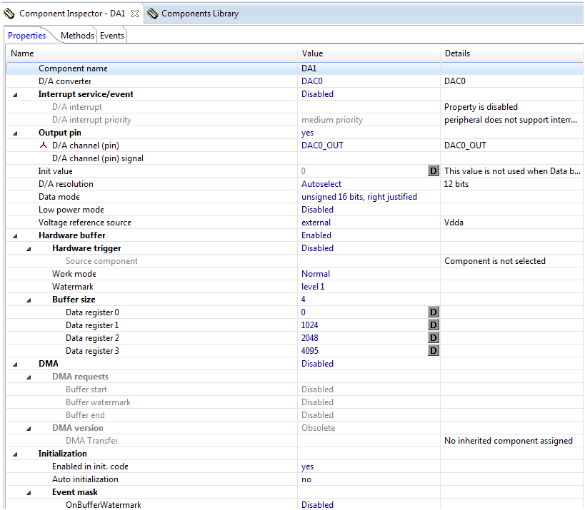

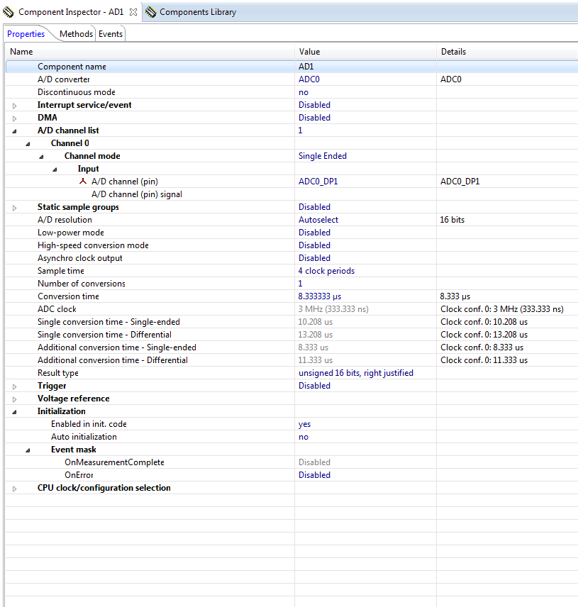

Hi everyone,
Basically for the past month I've been learning embedded programming while working with TWR-K40X256 (MK40DX256ZVMD10 micro-controller). Right now I'm tasked with converting a generic sinusoidal wave (like a sum of sines) via ADC, applying some basic digital signal processing to the data and then converting the processed digital data back to analog using DAC.
I've decided to use Processor Expert for this and so I've added the components DAC_LDD and ADC_LDD to the project (images of the configurations below).
Looking through the Typical Usage for both the components I've tried to implement a continuous measurement of a selected sample group (w/ interrupt service) without much success (measured values are always 0) and for the DAC part i am generally not sure about the way to implement the conversion.
Do you have some suggestions or code snippets on how to solve the problem/implement the system I explained?

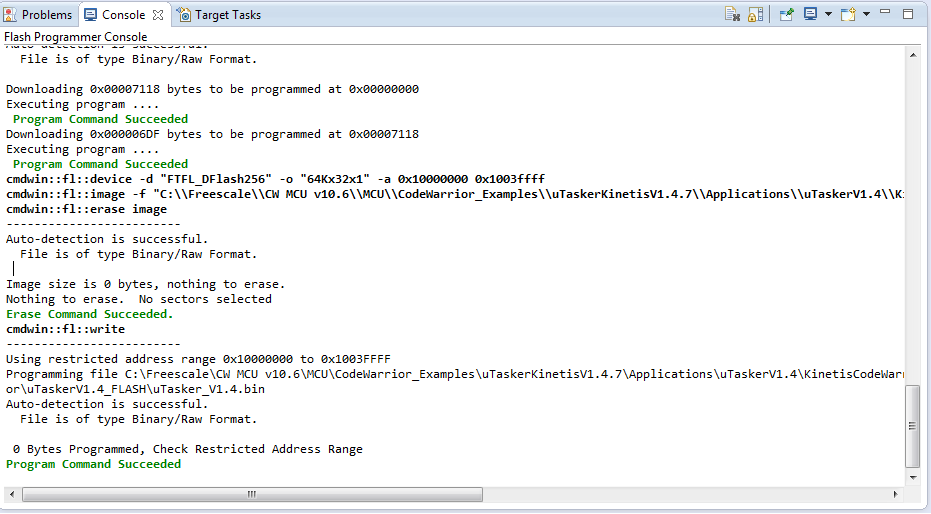

I think that you are downloading using the Flash utility and this output looks to be OK. I don't know why there are details about nothing being programmed to restricted regions but I get the same so it looks "normal". If you load with the debugger there is no such message. In the case of the Flash utility download you need to unplug and replug the USB cable for the new SW to start.
I just checked the result after configuring as in the other post (I set the Cortex M4 target and used the linker script file K_256_64.ld and both methods worked correctly - on the TWR-K40X256 you will see that the DAC0 output (pin A32 on the primary backplane connector)  has a voltage that follows the voltage on the potentiometer (ADC_DM1_SINGLE) but delayed by 1s due to the digital delay-line operation. I have attached the binary that I used which should be identical to yours if built with teh same settings and the same compiler version  (in fact I see that your is 0x7118 bytes in size which is exactly the size of mine).

Thank you so much for your in-depth answer! I've downloaded the uTasker project and configured it just like you said in the post response.
After that i tried to Flash Program it using the video tutorial in the KINETIS K Cortex M4 and KL Cortex M0+ uTasker webpage but I'm receiving some errors regarding the Restricted Adress Range (shown in the image below).
I would like to ask if this has something to do with some of the configurations on the project or just the configurations of the Flash Programming?

4,282 Views
franciscofernan
Hey Mark,
Thank you for all the help provided!
Although I've extensively read through all the files provided, I'm still having some problems about some of the parts and I'm trying to solve them singularly.
For starters you were completely right about the Flash programming! After testing the code with an oscilloscope i saw no flaws and everything was working out perfectly! I guess the inexperience of working with micro controllers got the best of me there :smileyhappy:

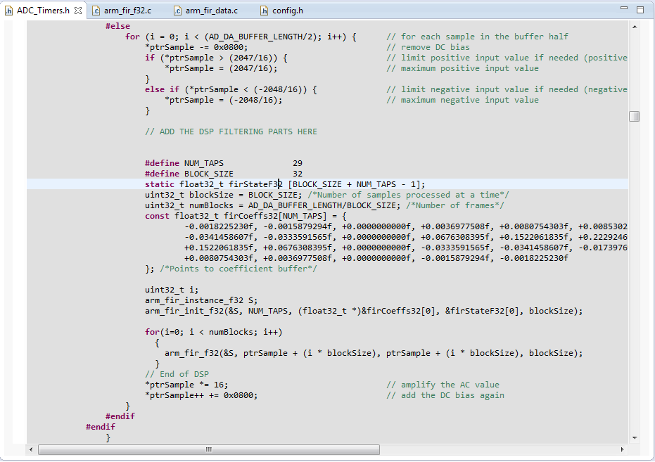

>> DSP Filtering Algorithms
For the past few days I've been trying to get the DPS project ready to integrate with the uTasker project. By now I have everything set up but I'm unsure about some of the next steps. In the DPS project I'm using the CMSIS-DSP library ( CMSIS-DSP: CMSIS DSP Software Library - link just for reference ) and I've managed to set it up completely on the uTasker project. The code that I've been writing is being written as shown in the image (I apologize for attaching too many images!) is this the right place to do so? Right before the signal is amplified by *16 and the digital bias is added?
**Note that the code isn't fully working right now and there are somethings that don't make sense inserted in uTasker :smileyhappy:

Francisco
I would remove the original signal multiplication and completely replace it with your own code. It looks like you have put your filter into the original loop which would mean that it is probably being performed too often (once for each sample in the buffer).
The thing to be aware of is that the code at the location is being executed each time half of the ADC samples are ready in the buffer and the pointer ptrSample will be alternating between the first half and the second half (with the new set of samples ready). I see that the samples are handled in blocks of 32 samplesd (BLOCK_SIZE) so you will need to ensure that the half buffer size is a multiple of this size and then you shouldn't have any problems with the filter algorithm operating on it.
