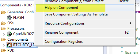

Hello. I am new at Kinetis and I am using the FDRM KE02Z40M. I need a clock in my project. There is something that I dont understand. When using the RTC_LDD component (provided by Processor Expert): Do have to add an extra device to my developing board? Such an DS1307 ? or the RTC is integrated inside de MCU?

Hello Juan:
The RTC_LDD makes use of the internal RTC module, so no need for an external device.
To start using this component, you can refer to the typical usage:
1) Right click on the RTC_LDD -> Help on Component:

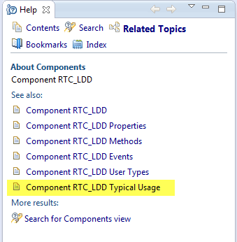

2) Click on "Component RTC_LDD Typical Usage":
Regards!,
