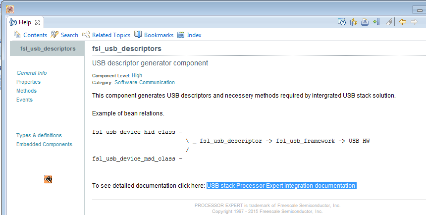

If you want to start a development of an application based on fsl_usb_.... components, you can use the Processor Expert Kinetis SDK USB Stack Integration User Guide that is available as a part of the help.
You can open the guide by the following way in KDS 2.0.0 (you must have KSDK 1.1.0 Eclipse Update installed):
- Open Component Library window and find fsl_usb_descriptors component.
- Open the context menu of this component (click by right button of the mouse) and select Help on Component item.
- In the Help window, open the fsl_usb_descriptions page
- The fsl_usb_descriptors help page (General Info tab) contains link to the user guide "USB stack Processor Expert integration documentation" at the bottom of the page.
