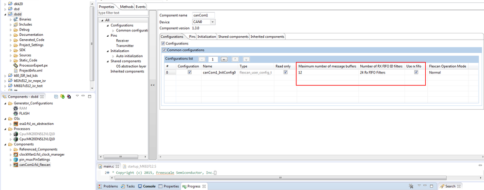

Hello Caio,
Yes , so far on the Processor Expert IDE or the Processor Expert on CW IDE  only support the feature for MSCAN device.
As workaround you could use "Message buffers" or freeze the code of this component and implement it manually.
And another method is use the KSDK1.3 + PE on KDS, it support this feature , and first you should make sure the KSDK1.3 support your
chip from the release not of KSDK1.3.
Hope it helps

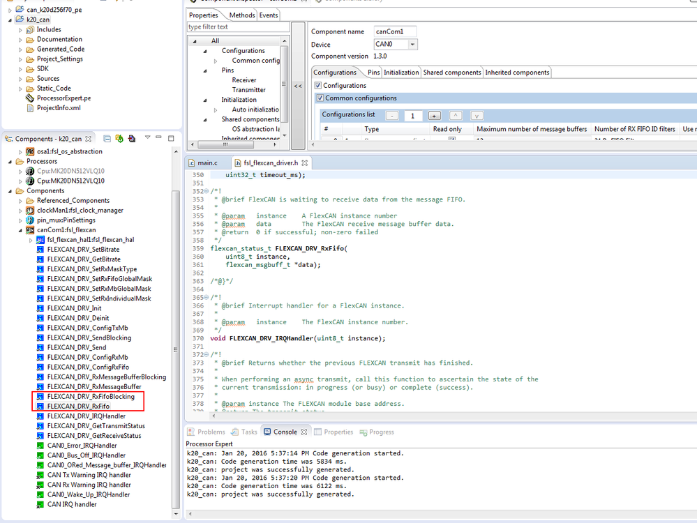

I do not know about using the methods of the component to set up the right way.
Can you help me?
thank you
3,221 Views
Hello Caio,
  what's about the error ?

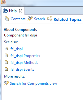

- The configuration of Processor Expert with KSDK is similar with PE,  about the detail configuration
you can refer to the "help on component"
Alice Yang
