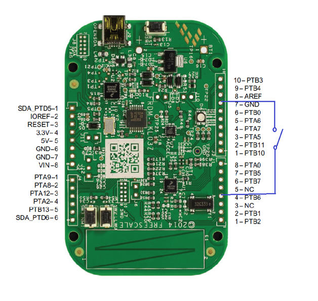

- When you short the pin PTB6 to ground 5 times (the pin is available on the 8 pin header connector – pin number 4; you can for example connect a button to the pin number 4 and ground) the processor is woken and the green LED start blinking (5 times).

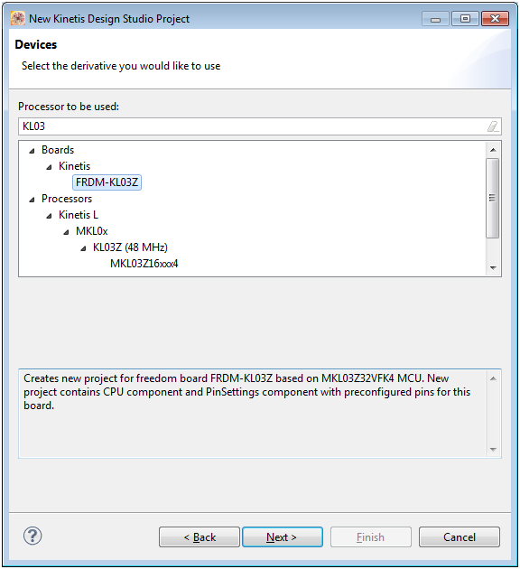

Create a new Kinetis design Studio project:
Select the FRDM-KL03Z board

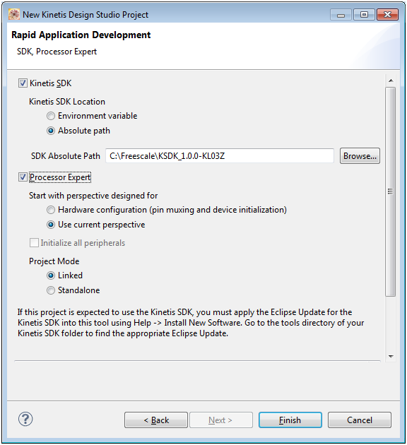

Select the Kinetis SDK path to the KSDK 1.0.0 for KL03Z and select Processor Expert

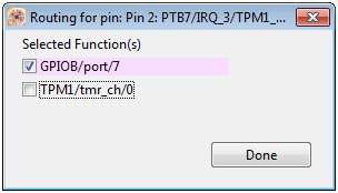

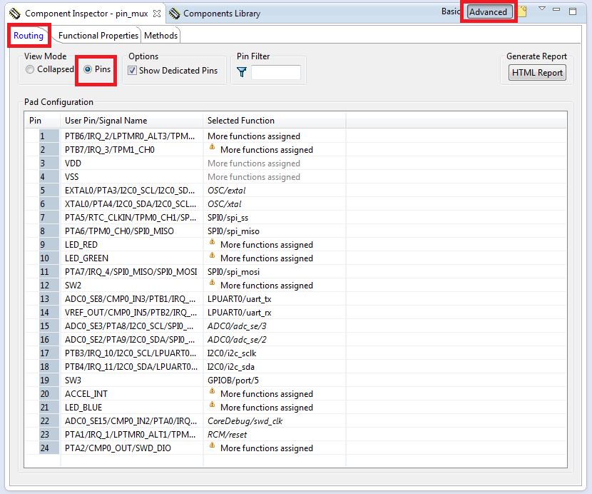

The application is created but there are many warnings reported in the Problems window saying that there is a conflict:
Ignored error: Selected value is in conflict with other configuration(s) property 'Pin 13', property 'CH1 - Channel 1', property 'Pin' from component gpio_pins, property 'ERCLK32K clock output' Exclusive connection required by property 'CH1 - Channel 1'; Selected value is in conflict with other configuration property 'CH1 - Channel 1', conflict in configuration of MUX bit-field of PORTB_PCR13 register. ; Selected value is in conflict with other configuration property 'Pin 13', property 'Pin' from component gpio_pins, conflict in configuration of MUX bit-field of PORTB_PCR13 register. (CLKOUT - Oscillator output), Low power demo KL03, ....
To resolve all these warnings you need to select the required functionality of reported pins in the PinSettings component: Open the Component Inspector of the PinSettings component, select the Routing tab and select the Pins View mode. All pins are available on one tab and you see small exclamation icons in rows where are reported conflicts:

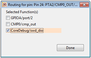

Click on each item with warning icon (the Selected Function row) and uncheck unused function of the pin to select one function only, i.e. you need to specify which functionality of the pin is initialized by code generated by Processor Expert.
You can select GPIO functionality in all case except the last pin number 24 that is used by debugger as swd_dio pin:
You can see that there is not any warning now and all pins are routed according to the selection you have done.

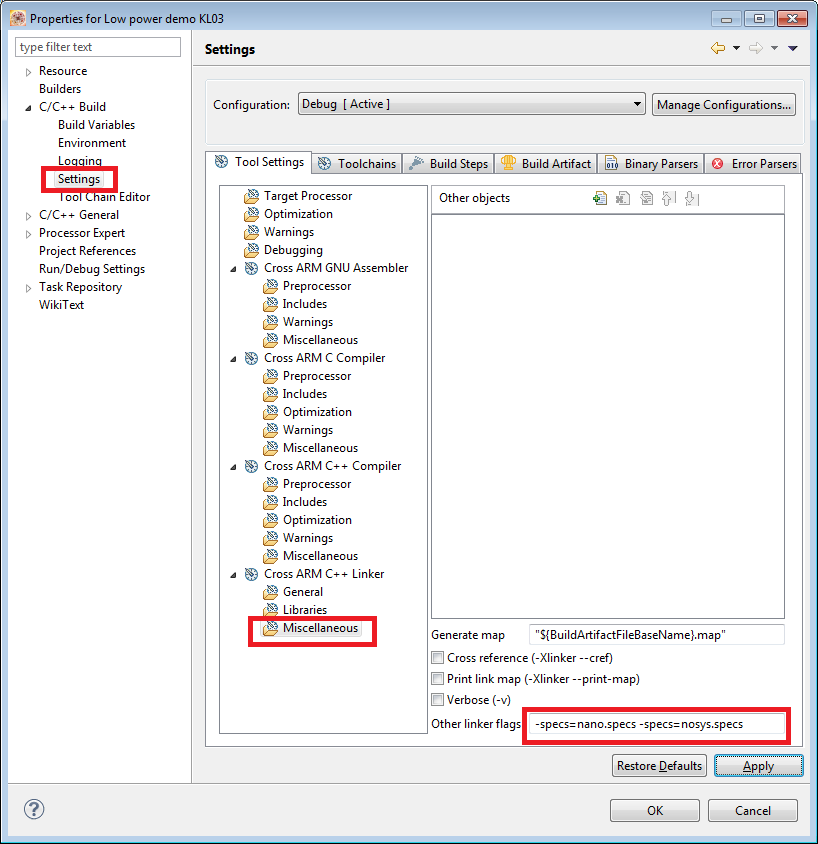

There is also necessary to change the linker settings when you have installed the new version of GCC tools (according to the document that is available in the KSDK 1.0.0 for KL03Z installation folder in KSDK_1.0.0-KL03Z\doc\Kinetis SDK Freescale Freedom FRDM-KL03Z Platform User’s Guide.pdf – chapter Appendix B: Kinetis Design Studio environment variable fix and swap tool chain)
Open the context menu of the project, select Properties item and change the Other linker flags settings to “-specs=nano.specs -specs=nosys.specs”, in C/C++ Build / Settings,  Tools Settigns tab, Cross ARM C++ Linker/Miscellaneous:

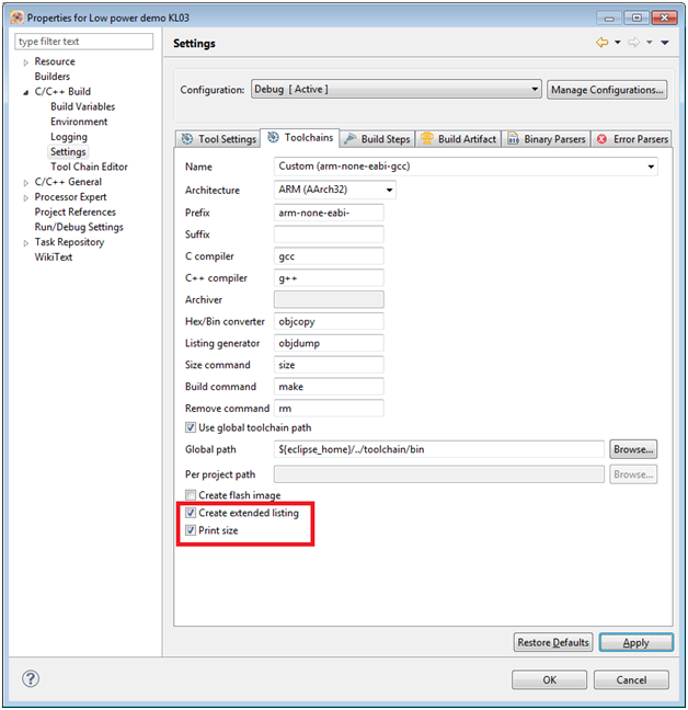

Tip
If you want to know details of compiled code and the code size, you can use the following options to create extended list file and print code size info on the following Toolchains tab:

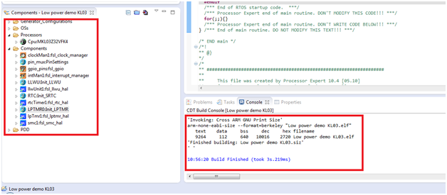

You can generate Processor Expert code and process Build of the application without any error and warning.
When the Build is finished the following information is provided in the Console window:
'Invoking: Cross ARM GNU Create Listing'
arm-none-eabi-objdump --source --all-headers --demangle --line-numbers --wide "Low power demo KL03.elf" > "Low power demo KL03.lst"
'Finished building: Low power demo KL03.lst'
'Invoking: Cross ARM GNU Print Size'
arm-none-eabi-size --format=berkeley "Low power demo KL03.elf"
   text          data           bss           dec           hex       filename
   8860           112           640          9612          258c       Low power demo KL03.elf
'Finished building: Low power demo KL03.siz'

You can see routing of all pins when you generate report of PinSettings component. Open the Component Inspector of PinSettins, Routing tab and click on the HTML Report button.
We will use the SW2 button to wakeup the CPU and the green LED for indication of the CPU state.
Adding Processor Expert components
Now you can add all components for the low power demo application.
  • Init_LLWU and fsl_llwu_hal components to control LLWU device
  • Init_SRTC and fsl_rtc_hal to control RTC device
  • Init_LPTMR and fsl_lptmr_hal to control LPTMR device
  • fsl_smc_hal to control SMC (System Mode Controller) device

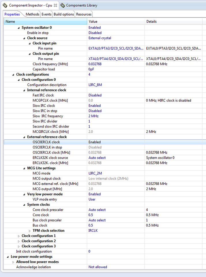

CPU device
We are going to use external oscillator 32768Hz and we need to configure device to allow Very Low Leakage Stop modes. There are set following properties in the Component Inspector of the CPU (switch to Advance view):
  • Check that the Clock settings/Clock Sources/System oscillator 0 property is Enabled and set Enable in stop property to Enabled. The Clock source, clock pins and clock frequency are preset for the FRDM-KL03Z board.
  • Go to the Clock configuration/Clock Configuration 0 and set:
    • Internal reference clock/Slow IRC frequency to 2MHz (it is enough for our demo application and it also decreases power consumption).
    • MCG lite settings/MCG mode set to LIRC_2M
    • Very low power mode to Enabled (leave setting of VLP mode entry to User because the VLLS1 mode is entered after blinking; we will write the code to enter VLLS1 mode)
    • System clocks/Core clock set to 0.5Mhz
    • System clocks/Bus clock set to 0.5Mhz (it allow us to enter very low leakage stop modes)
  • Set Low Power mode settings/Acknowledge isolation to Not allowed value (we will do it in the user code)

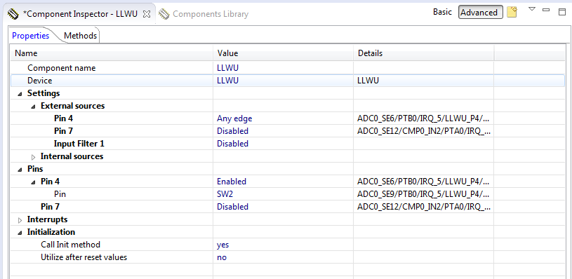

LLWU (Low-Leakage Wakeup unit) device
Open the Component Inspector of Init_LLWU, switch to Advance view and set following properties:
  • Set Settings/External Source/Pin 4 to Any edge value (we will use this pin that is connected to SW2 button)
  • Set Pins/Pin 4 to Enabled and select SW2 in the item below
  • Set Initialization/Utilize after reset values to no
We will use the LLWU to wake-up the CPU and we need not any interrupt.

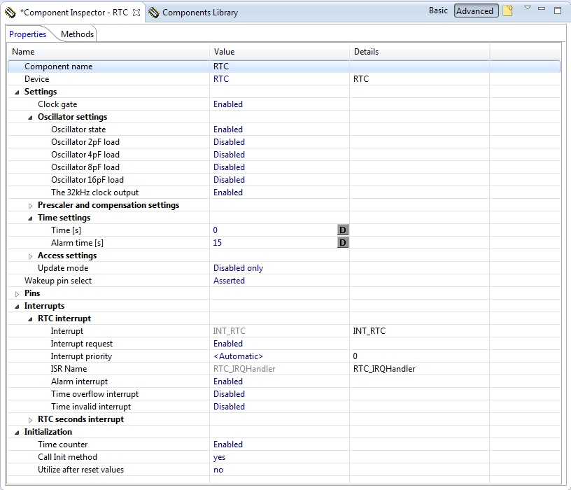

RTC (Real Time Clock) device
Open the Component Inspector of Init_SRTC, switch to Advance view and set following properties:
  • Set Settings/Clock gate to Enabled
  • Set Settings/Oscillator settings/Oscillator state to Enabled (it enables external oscillator also in stop modes)
  • Set Settings/Time settins/Alarm time [s] to 15 (15 seconds timeout to wake-up from VLLS1 mode)
  • Set Interrupts/ RTC interrupt/Interrupt request to Enabled
  • Set Interrupts/ RTC interrupt/Time overflow interrupt to Disabled
  • Set Interrupts/ RTC interrupt/Time invalid interrupt to Disabled
  • Set Initialization/Time counter to Enabled

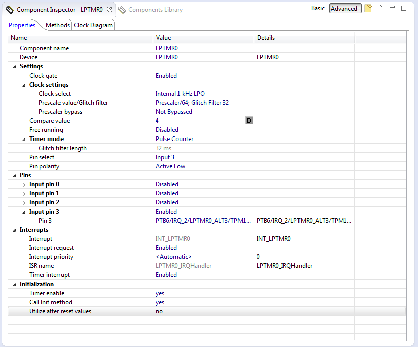

LPTMR (Low-Power Timer) device
Open the Component Inspector of Init_LPTMR, switch to Advance view and set following properties:
  • Set Settings/Clock settings/Clock select to Internal 1kHz LPO (this clock source is enabled in the VLLS1 mode)
  • Set Settings/Clock settings/Prescale value/Glitch filter to Prescaler/64; Glitch Filter 32 (it will eliminates glitches on connected button that will be used for generating pulses)
  • Set Settings/Compare value to 4 (the LPTMR interrupt is invoked when the compare value is equal to counter and the counter value is increased, i.e. 5 pulses on the input pins invoke the LPTMR interrupt)
  • Set Settings/Timer mode to Pulse Counter (we will use the timer to count external pulses on the input pin 3)
  • Set Settings/Pin select to Input 3
  • Set Settings/Pin polarity to Active Low
  • Set Pins/Input pin 3 to Enabled and select PTB6/IRQ_2/LPTMR0_ALT3/TPM1_CH1, TPM_CLKIN1 in Pin 3 item.
  • Set Interrupts/Interrupt request to Enabled
  • Set Interrupts/Timer interrupt to Enabled (we will use the timer interrupt to wake-up CPU from VLLS1 mode after 5 pulses on the input 3 pin)
  • Set Initialization/Timer enable to yes

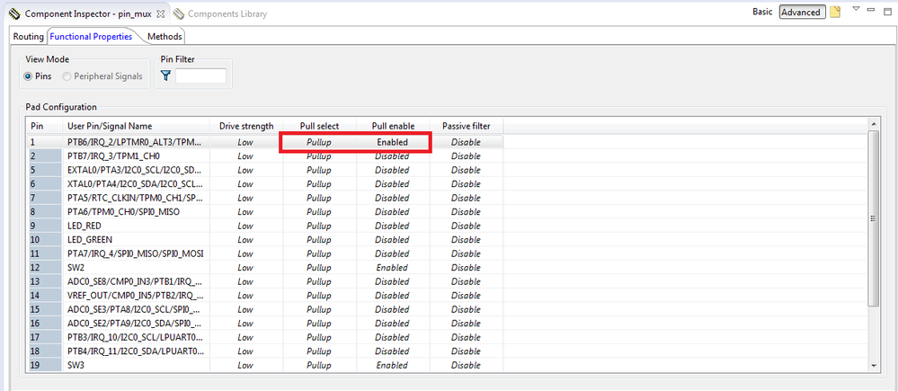

To avoid glitches on the PTB6 pin, that is used as input pin of the LPTMR, we will also enable pull-up in the PinSettins. Open Component Inspector of the PinSettings, select Functional Properties tab and set the pin number 1 (PTB6) as follows:
We have finished design time settings of Processor Expert components and we are ready to write the application code.
When you generate code and Build the application there will not be any error or warning. The Processor Expert project looks as follow:

       SMC_HAL_SetMode(SMC_BASE, &smcConfig);
It is all code we need for our low power demo application. The application can be built and run now.

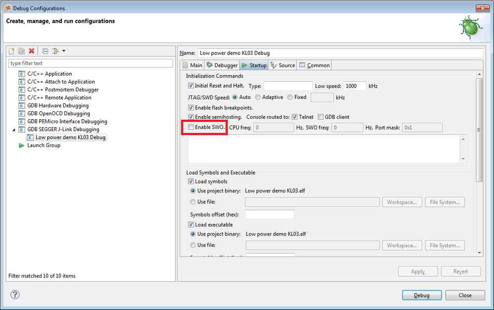

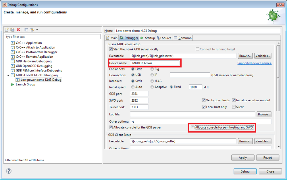

The application does not contain any debug connection by default in KDS 1.1.1. The KDS 2.0.0 contains debug configurations but the settings must be updated according to following description. We just need to add (modify) a debug configuration for our FRDM-KL03Z board and Open SDA Segger j-link debugger.
Open the context menu of the Low power demo KL03 project in the Project Explorer window and select Debug As > Debug Configurations ....
In the Debug Configuration window double click on the GDB SEGGER J-Link Debugger item and a new Low power demo KL03 Debug configuration is created.
Select the Debugger tab and enter the Device name: MKL03Z32xxx4 (you can find the correct CPU name in list when you open Support device names link that is located to right of this item). Uncheck Allocate console for semihosting and SWO (SWO is not support by OpenSDA SEGGER J-link).
Go to on Startup tab and uncheck the Enable SWO option (SWO is not supported by OpenSDA SEGGER J-link).
Click on the Apply and Debug button and the debugger starts (you must have the FRDM-KL03Z board connected to the workstation).

If you want to connect a button for the LPTMR pulses generating you can connect one pin of the button to the PTB6 on pin #4 of 8-pins connector J1 and the second pin of the button to the GND to the pin #7 of the 10-pins connector J2, see below:

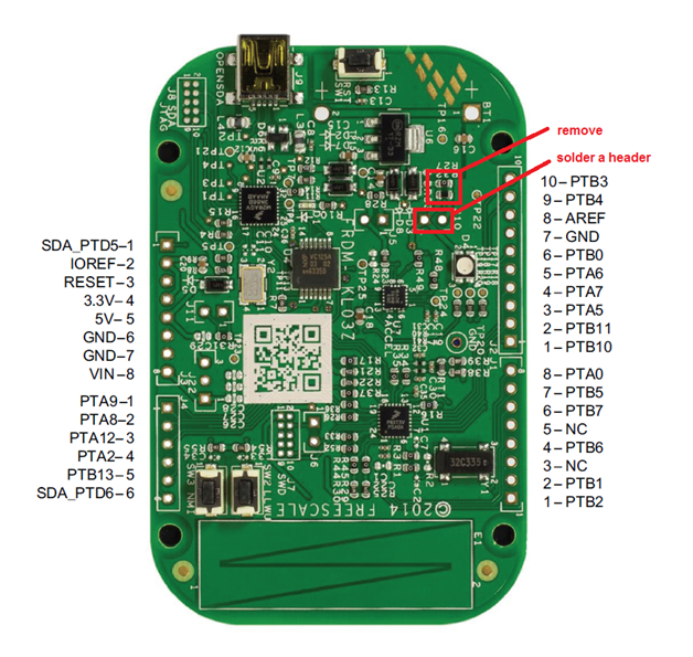

There is also possible to measure power consumption of the CPU in VLLS1 mode. It is described in the FRDM-KL03 User Guide. Just unsolder R27 and R28 and solder a header pins to J10 position of the board. You must use jumper for J10 now to connect power supply for the CPU and when the jumper is removed you can use these two pins to measure the energy consumption of the CPU (e.g. by a multimeter).
