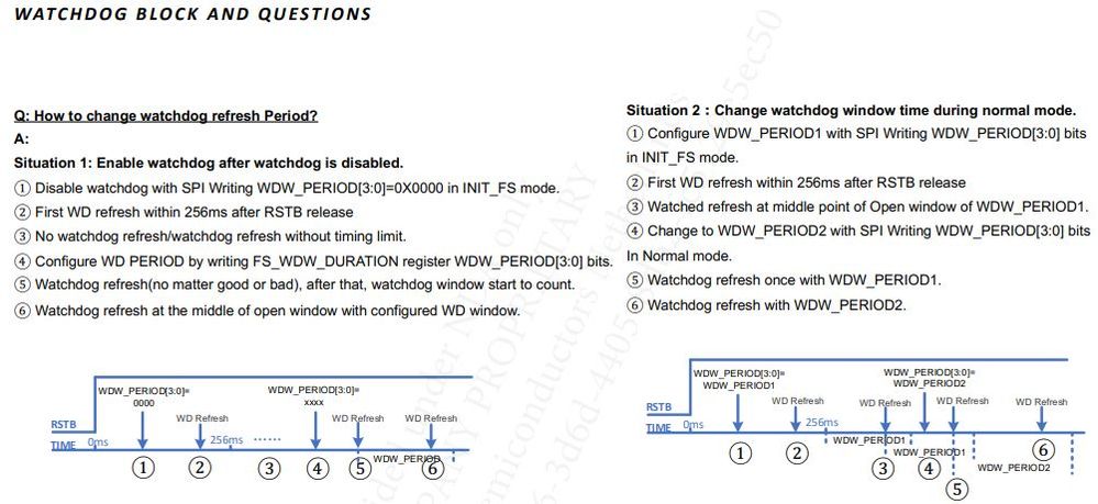

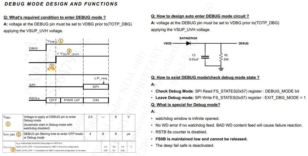

First of all, please check if the FS26 is in Debug mode or not.
In Debug mode, the INIT FS window (256ms) is infinite and the WD window is fully opened meaning WD timing errors are not taken into account (the watchdog error counter will not be incremented).

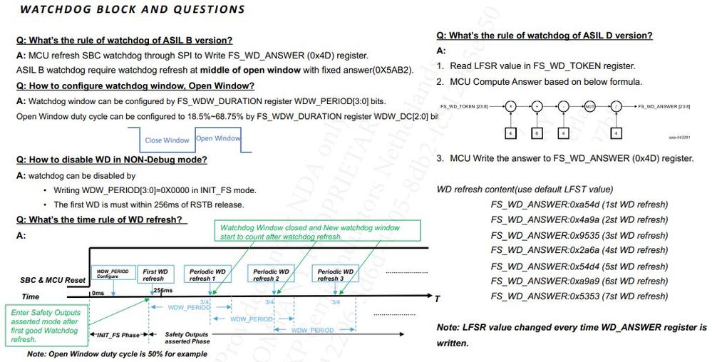

In non-Debug mode, the first WD refresh must happen before INIT_FS timeout (256ms), the second and other should happen in the WD open window what is more restrictive.
The WD window duty cycle is configurable using WDW_DC[2:0] and by default is set to 50%.
The Watchdog impact on RSTB is configurable using WD_FS_REACTION [1:0] bits. By default (0b10) both RSTB and FS0B are asserted low if WD Error counter value = WD_ERR_LIMIT[1:0].

Is the Totpdbg timing window strictly required to fall within 4–8 µs?
On my debug board, I measured a Totpdbg value of 5 ms, and debug mode was successfully entered.
Does this confirm compliance with the specification—or is the tolerance wider than stated?

The first WD refresh occurred before the INIT_FS timeout, and the FS26 successfully transitioned to the FS_Normal state. However, even after some time has passed, if the WD refresh is not called, the FS26 does not reset. During this time, if we check the FS_STATE, it remains in the Normal state and does not transition back to INIT_FS.
After transitioning to the FS_Normal state, if the WD refresh is called once and then not continuously called, the FS26 resets.
