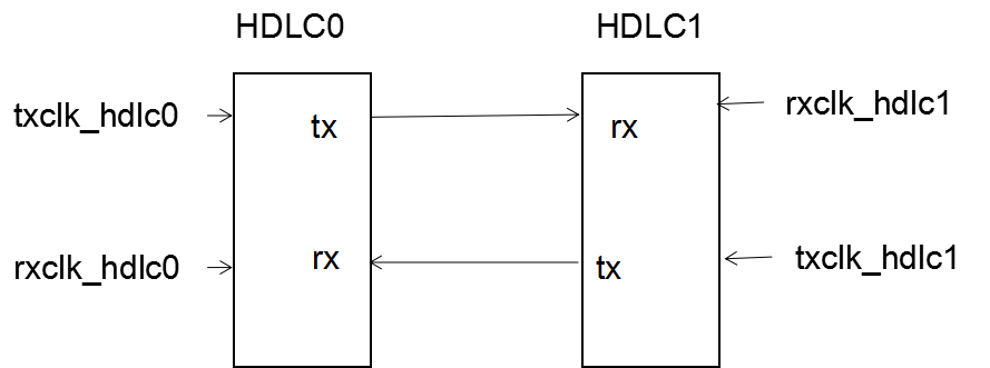

I encounter a very strange issue about HDLC.
For the HDLC,  in my design, uses external clock,
during debug,  find that, if feed the HDLC's rx/rx clock with different frequency clock, HDLC rx channel
will can not receive data any more.
Does it need to do some special setting for HDLC if RX/TX clock is different frequency?
Could you help to give some suggestions?

Could you please draw the exact connection circuit of both sides P1012 and remote device, and both TX and RX side, and show how exactly (from which source) the clock is applied for all four cases (P1012tx, P1012rx, remote tx, remote tx).

I use the different HDLC peripherals of the same P1021 chip to communicate. The connection relationship is as below:
As the above figure said:
txclk_hdlc0, rxclk_hdlc1: 8M
rxclk_hddlc0, txclk_hdlc1: 16M
we have done the below experiments:
1) use 16M clock to communicate
    That is, HDLC1 send and HDLC0 receive, there are only send interrupt and no receive interrupt, receive side
     can not receive data;
2) use 8M clock to communicate
    That is, HDLC0 send and HDLC1 receive, there are send interrupt and receive interrupt, but the receive side
    will pop out error in the BD status field.
Thank you!

Sorre, the figure is not clear, please answer following questions.
1. Please confirm txclk_hdlc0 and rxclk_hdlc1 is the same clock, sourced from the same (one) clock source.
2. Please confirm rxclk_hddlc0 and txclk_hdlc1 is the same clock, sourced from the same (one) clock source.
1,581 Views
carlpeng
Hello Alexander,
yes,
yes, txclk_hdlc0 and rxclk_hdlc1 is from the same crystal oscillator with 8M frequency.
yes, rxclk_hddlc0 and txclk_hdlc1 is from the same crystal oscillator with 16M frequency.
