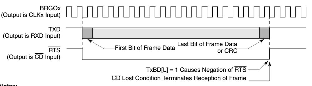

I have some puzzles for transparent controller of p1012 QE, could you please give some suggestions?
The questions is:  how to detect end of frame in the transparent transfer?
As the QEIWRM.pdf said, user must use the CD line to alert the transparent controller of the end of frame.
but as the below figure show:
we can find that, if CD is negation, will be CD lost, then in the RxBD, the CD flag will be set, controller consider
that a CD lost happened, and the frame will be discarded.
so, my question is how to use CD line to alert the end of frame?

First we should define what is frame in the transparent mode. For example software can test received stream for predefined pattern which is recognized as a frame delimiter. In this case CD lost before the end of frame pattern will abort frame reception and CD lost is considered as error.
The CD lost itself also can be used to signal end of frame. I.e. the CD signal may envelope the frame. In this case negation of CD just terminates frame reception. This is shown on your figure (CD Lost Condition Terminates Reception of Frame). Notice on CD lost the transparent receiver closes Rx buffer and besides CD bit it also sets the last (L) bit and writes the number of frame octets to the data length field.

Since when controller detects the CD lost condition, it will discard the frame, so we can not
read the received frame.

r8070z
