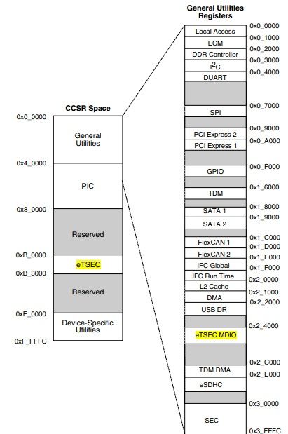

This problem appears relatively small probability. I let p1010 CCSR map in 0xffe00000,but,When many times to restart p1010 device ,   p1010'  eTSEC and eTSEC MDIO may  map error  lead to eth not normal, other ccsr space map is normal.  I read p1010'  eTSEC and eTSEC MDIO map region ,all is 0;  write is also not normal,  other space read and write is normal.

Hello  Zhang wenjian,
In u-boot, CCSR is also configured at 0xffe00000, please refer to the following memory dump on P1010RDB.
I think problem should be caused by the improper eTSEC configuration.

This problem appears relatively small probability.  when appears  this problem,  the flowing is specfic information,  p1010'  eTSEC and eTSEC MDIO map region ,all is 0;  other map region is nornal
SMM#

when every is ok, the flowing is specfic information,     p1010'  eTSEC and eTSEC MDIO map region is correctly。

Hello zhang wenjian,
Would you please provide more detailed information about how to reproduce the problem memory dump?
Yiping
4,055 Views
zhangwenjian
Continuous  reset  in uboot  stage, several hours  may reproduce the problem .
4,053 Views
ufedor
Please refer to the P1010 QorIQ Integrated Processor Hardware Specifications, 2.4 Reset Initialization and 2.5 Power-on ramp rate to ensure that all reset timings and power supplies ramps are correct.
Refer to the AN4534 - P1010 QorIQ Integrated Processor Design Checklist and check termination of all unused signals and signals having explicit termination requirements.
