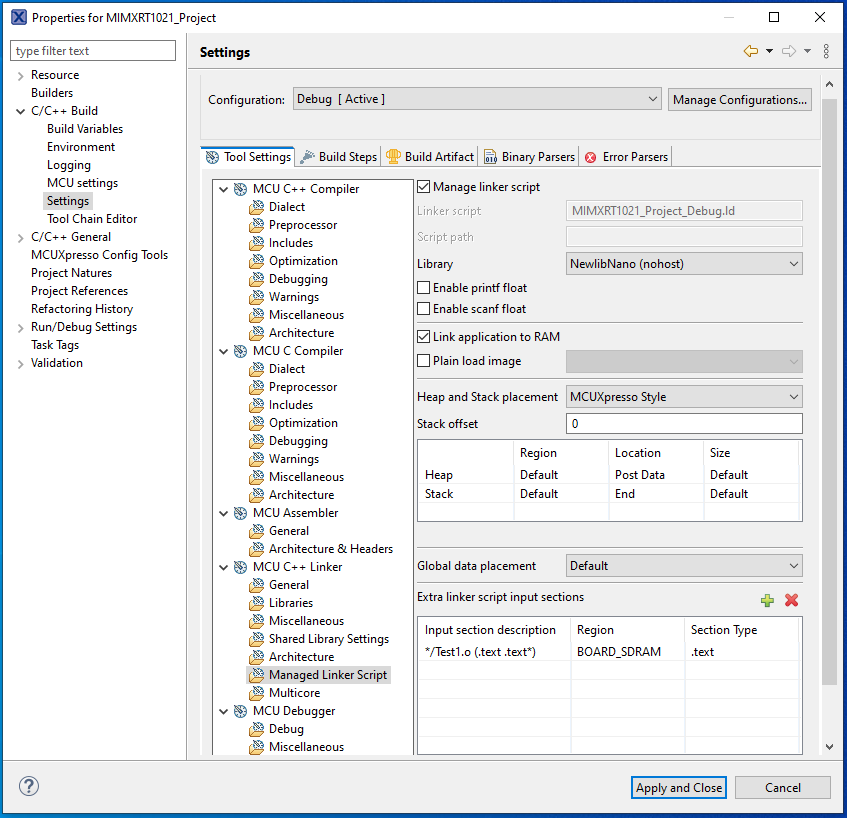

I'm using MIMXRT1021 evaluation board in which I want to put the entire C++ file into external SDRAM.
In MCUXpresso project settings there is one option to Manage Linker script but I'm not getting any reference to add file into SDRAM section.
I've tried but not able to do the same. Please guide me further.

This post should meet your needs, please refer to it: https://mcuoneclipse.com/2021/05/26/placing-code-in-sections-with-managed-gnu-linker-scripts/

I've tried this way but my MIMXRT1021_Project_Debug.ld file does not update after doing this steps.

Is your *.cpp file in the source folder? This should be necessary.

Yes my Test1.cpp file is in the source folder.
Can you verify - */Test1.o (.text .text*)
Is this the correct way of adding file name?

On my side, I have implemented a method to put a C file into SDRAM. Please refer to <MCUXpresso IDE User Guide> Chapter 20.13.5 Placing specific functions into RAM blocks.
// test.h
#ifndef TEST_H_
#define TEST_H_
#ifdef __cplusplus
extern "C" {
#endif
#include <cr_section_macros.h>
__RAMFUNC(RAM2) void my_function(void);
#ifdef __cplusplus
#endif
#endif /* TEST_H_ */
Hope it helps!
