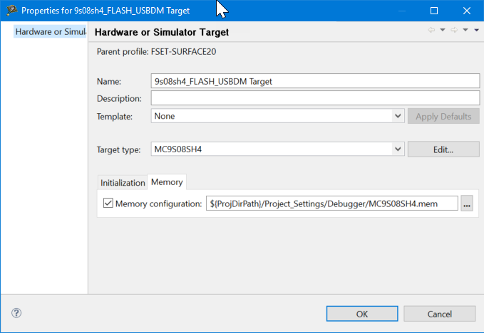

The bad news is that CodeWarrior will not select it as debug hardware. In Debug Settings I select the Connection Type  "USBDM HCS Interface" and Preferred BDM as "USBDM-JS16-SWD_SER-0001" I get the message : -
Error launching DEO_01_Issue_6_FLASH_PnE U-Multilink
There was an error parsing the memory configuration file

Hi Julian,
It should not be necessary to select anything in the debug settings and, in fact, it's quite hard to create a debug setting from scratch since the debugger startup and memory files depend on the target
If you create a new project with the USBDM interface does the launch configuration look correct?
see USBDM: Codewarrior - Eclipse V10.x
The error message seems to be indicating that it is looking for the wrong kind of interface and/or is missing a memory configuration file which is part of the  Target settings

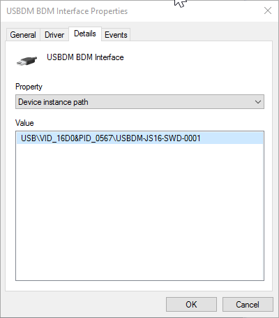

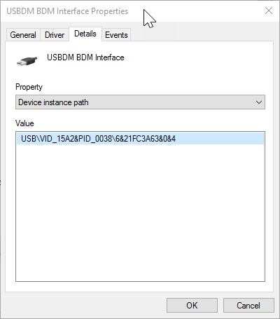

Hi Julian,
I suspect the device is in in-circuit-programming (ICP) mode.
Try the following please:
  • Open device manager
  • Right-click on the device and open properties
  • Select Details Tab
  • Select Device instance path
  • If it shows something like USB\VID_15A2&PID_0038\... it is in ICP mode
  • It should show something like USB\VID_16D0&PID_0567\USBDM-JS16-SWD-0001
  • If in ICP mode please reflash the firmware from scratch using the instructions here: USBDM: BDM Construction and Firmware (from the top of the page using the JS16 First stage bootloader)
Bye
