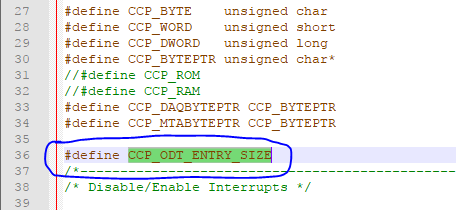

When I use INCA with 5643l,I find a bug.The CCP cannot observe the mearment veriable.Then I add a define in CCPPAR.H,the ccp can work with INCA.

Hi hongjinzeng‌,
Thank you for reporting and fixing this issue.
It is currently recording into our database as: AST-938
