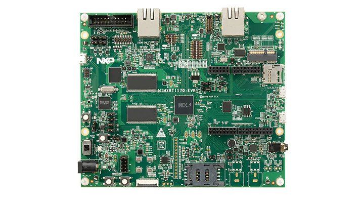

For the development of this application, the i.MX RT1170 Evaluation board was used with a MIMXRT1176 CPU, and the attached ON Semiconductor OV5640 camera. Additionally, the RK055AHD091 LCD panel can be used to visualize the frames from the camera.
The i.MX RT1170 EVK provides a high-performance solution in a highly integrated board. It consists of a 6-layer PCB with through hole design for better EMC performance at a low cost, and it includes key components and interfaces.
Some of the i.MX RT1170 EVK main features are:
  • MIPI camera sensor connector and MIPI LCD connector
  • JTAG connector and On-board DAP-Link debugger
  • Connectivity: 2x Micro-USB OTG connectors, Ethernet (10/100/1000M) connector, Ethernet (10/100M) connector, SIM card slot, CAN transceivers
  • 5V Power Supply connector
For a more comprehensive view and a more detailed description regarding hardware specifications and user guides, please check the documentation here.

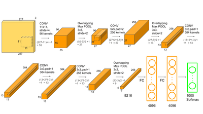

Deep Learning – Facial recognition
Facial recognition is the process of verifying a person’s identity through their facial features in order to grant access to a service, application, or system. Recognition needs to be performed in 2 steps: 1) face detection – so identifying and isolating the face area from an image and 2) face recognition – analyzing the features of the image and classifying them. In this example, face detection is performed with the CascadeObjectDetector, from the Matlab Computer Vision Toolbox, which is based on the Viola-Jones algorithm, and face recognition will be performed with AlexNet, a pre-trained neural network specialized for object classification.
source: https://test.neurohive.io/en/popular-networks/alexnet-imagenet-classification-with-deep-convolutional-neural-networks/source: https://test.neurohive.io/en/popular-networks/alexnet-imagenet-classification-with-deep-convolutional-neural-networks/

For training the network, we need to modify the output layer of the AlexNet network to match the number of classes we use, in this example 6. To improve the results for the case where we might not have enough input data, we can augment the images, and for that, we use the imageDataAugmenter from Matlab, where we set the images to be flipped horizontally and/or vertically, and rotated with a random angle between -90 and 90 degrees. This will help the model to avoid overfitting and generalize better.

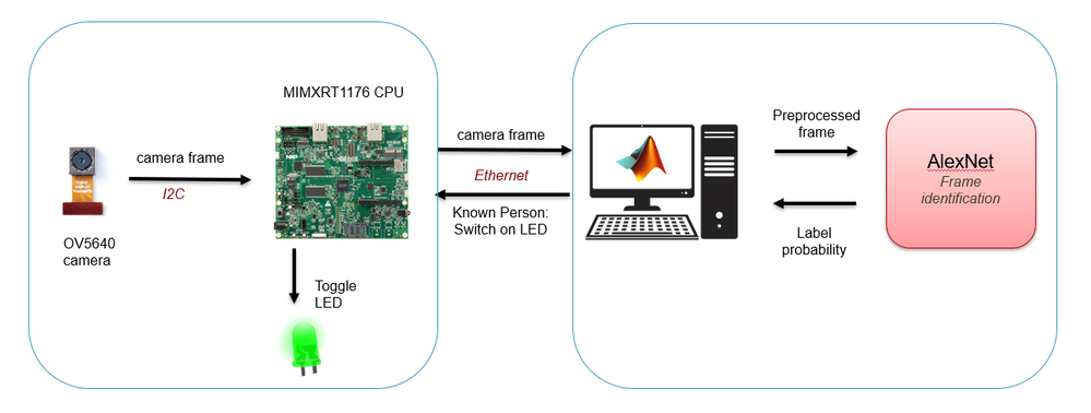

Running in co-simulation mode means that the target board is able to communicate with the host (in this case, Matlab) through the TCP/IP protocol, thus exploiting both hardware and Matlab software capabilities. The logic of the application is presented in the following figure: the attached camera will send the captured frames to the computer through an Ethernet connection; there, the frame will be processed using a Matlab script, which will perform Face detection and be further sent to the AlexNet trained classifier, which will return a label and the probability of that label being correct. Then, based on whether the person was recognized or not, a signal will be sent to the IMXRT board to toggle the USER LED.

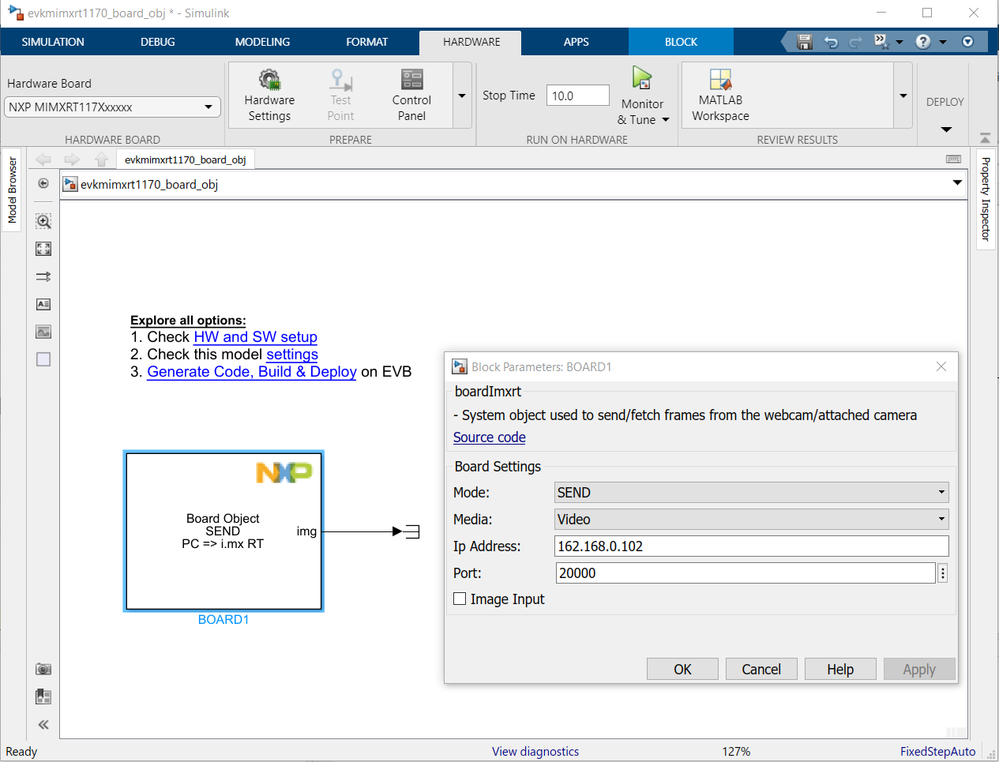

In order to create the executable that will act as the server part of our application, we will create a new Simulink model containing the IMXRT Board Object.
For this example, the Board Object is sufficient for creating the co-simulation environment and running the application, for it makes use of both Camera and LWIP functionalities:

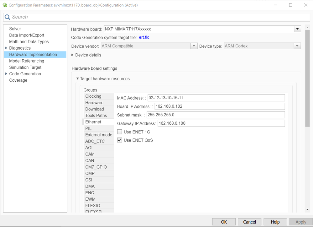

The next step would be to configure the Board Object in order to be able to communicate with the host: open the Block Parameters window and input the IP address and port number you want to use. In the case of the server, it does not matter whether it is configured in SEND or GET mode, because it will wait for commands from the client.

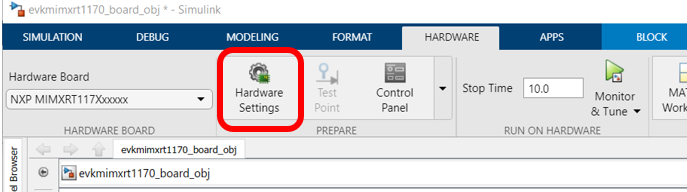

Then the model’s Ethernet parameters need to be configured. Open the Configuration Parameters window from Simulink, select Hardware Implementation from the left menu and then go to the Ethernet tab: here insert the values of the board IP address, subnet mask, and the gateway address.
Connect the board through USB to the computer. Go to the Download tab and select the drive you want to download the executable to. More information about this process is presented here. Also, please make sure that you have selected the NXP MIMXRT117Xxxxxx Hardware Board.

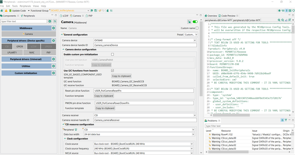

The selection of the MIMXRT117X Hardware Board should copy the default ConfigTool MEX file which you can modify, but you can also create or use another MEX file as long as it has the name <model_name>_<core>Config.mex.
In the MEX file are configured the peripherals and pins settings, in this case the Camera peripheral and the GPIO User LED. For better performance, we recommend using a low-resolution for the Camera.

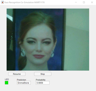

After the application has received the camera frame from the board, it can start the preprocessing required for classification. We create a face detector object using the CascadeObjectDetector, to which we will input the camera frame and we receive in exchange the margins of the box where it detected a face. In the case a face was detected, we crop the image and resize it to 227x227x3, which is the size the AlexNet network requires, and we classify the image using the loaded model.
The USER LED on the board will be switched on if the person was identified. The script also provides a Matlab UI Figure for better visualization.
