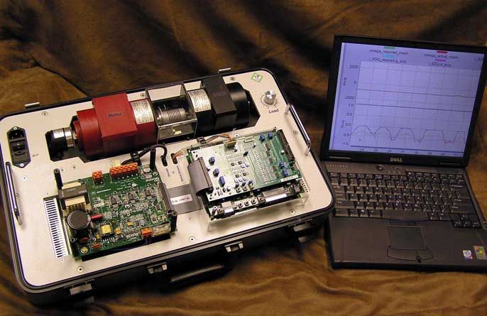

  • Running on a 3-Phase SR HV Motor Control Development Platform

Block Diagram
Board
