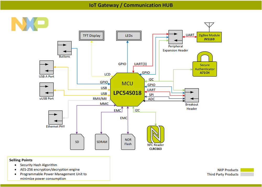

Block Diagram
Block-Diagram-IoT Gateway Communication HUB-PNG.pngBlock-Diagram-IoT Gateway Communication HUB-PNG.png
Product
Category MCU
Product URL LPC540XX: Power-Efficient Microcontrollers (MCUs) with Advanced Peripherals Based on Arm® Cortex®-M4...
Product Description Offering flashless design and security integration, the LPC540xx family of MCUs combines a 180 MHz Arm® Cortex®-M4 core with a power-efficient and unique architecture, advanced HMI and flexible communication peripherals for real-time performance in the next-generation IoT.
Category NFC
Product URL CLRC663 plus family: High-performance NFC frontends
Product Description If you need high NFC performance or the lowest power consumption, use this remarkably efficient yet highly flexible frontend family to push your design further.
Category Secure
Product URL A71CH: Plug and Trust - The fast, easy way to deploy secure IoT connections
Product Description
A71CH is a ready-to-use secure element for IoT devices providing a root of trust at the IC level and delivers, chip-to-cloud security right out of the box, so you can safely connect to IoT clouds and services, including AWS, IBM Watson IoT™ Platform, and Google Cloud™ IoT Core without writing security code or exposing keys.
Category Wireless
Product URL JN5169: ZigBee and IEEE802.15.4 wireless microcontroller with 512 kB Flash, 32 kB RAM
Product Description The JN5169 is an ultra low power, high performance wireless microcontroller suitable for ZigBee applications.
