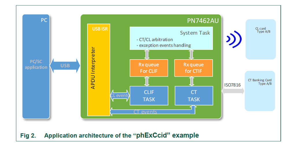

Isn't it possible that using APDU provided by PN7462 user guide, I send command to reader and get response from reader?? Irrespective of NFC reader library. NFC Reader lib seems complicate.
I want something like NFC which I do not need to modify, which will perform Tag and Reader communication. And another application, which will respond my commands and get me a Tag.
Using above concept I will prepare command for PN7462 instead of PN532, without taking care of NFC.
Utsavi B.
2,579 Views
Kan_Li
Hi Utsavi B.,
Looks like you prefer to mostly focus on the application layer, so maybe a ready USB NFC reader is what you are looking for, but we are just IC supplier so we only have NFC reader solution such as PN7462AU, which has a CCID demo might be close to your requirement, but you still have to build your own application based on that.
Please refer to UM10915 for more details.
