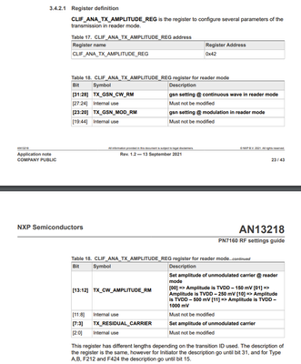

  • As you wrote, the output power can be adjusted via LDO register settings -> So you can reduce the VDD(Tx) voltage to 3V
  • You can also reduce the output power via "CLIF_ANA_TX_AMPLITUDE_REG"
    • GSN value and TX Amplitude

Anyway since you radiate quite high RF power by your antenna which is typically close to the PCB with electronic. So I expect that some RF noise can be always measured on the device due to the magnetic coupling (signal or GND loops).

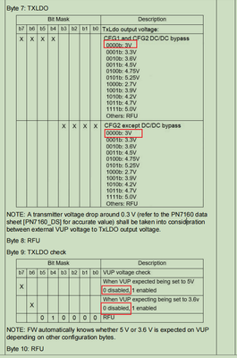

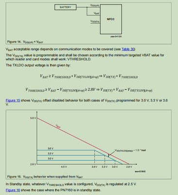

I see the following description from Datasheet, does it mean that I can modify VDD(tx) by software
 Battery voltage is 4V ,modify core configuration parameters PMU_CFG Byte7&Byte9 like this

KellyLi
Hello @ethan_dang1
Yes, you’re absolutely correct, the output of the TXLDO can be configured via NCI commands. It was my negligence and say sorry to you. But the RF signal is coupled to GND, which should be closely related to PCB LAYOUT, or can you share your GND waveform diagram?
