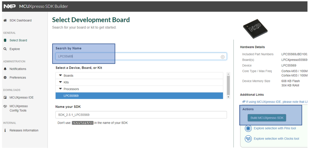

  2. Next step is to use the MCUXpresso SDK Builder tool to build and download the SDK for LPC55S69. For this:
    1. Go to  the MCUXpresso SDK Builder website: https://mcuxpresso.nxp.com/en/select
    2. Select the LPC55S69 board and then click on ‘Build MCUXpresso SDK’ button:

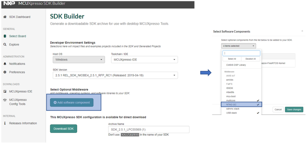

    3. Click on ‘Add Software component’, then select the NTAG I2C component, click ‘Save changes’ and then download the SDK.

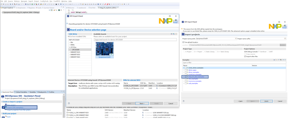

  3. Drag and drop the downloaded SDK to the installed SDK’s tab in the MCUXpresso IDE to install it.

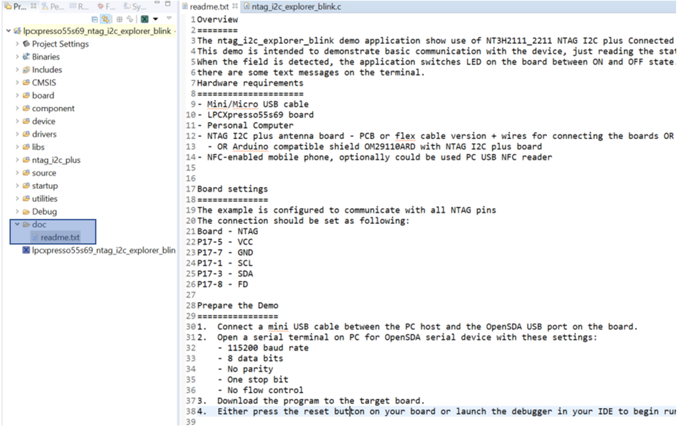

  4. Click on the ‘Import SDK example(s)’ in the Quickstart Panel in the MCUXpresso IDE. Then select LPC55S69, ‘check the ntag_i2c_plus_example’ box and hit ‘Finish’.
  5. Connect the LPC55S69 and NTAG I²C plus boards together. Details of these connections can be found in the “readme.txt” file in the “doc” folder of the project:

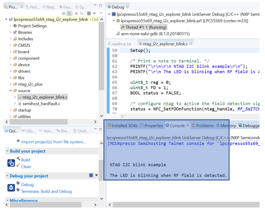

  6. Finally click on debug in the Quickstart Panel to build the project, flash it to the MCU, and start debugging.
This is how the output looks like in the Console tab of IDE:

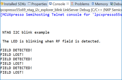

Bring any active nfc device (e.g. an NFC phone with NFC enabled) near the ntagi2c board. The program will detect it and consequently blink the LED as well as display a message on the console:
