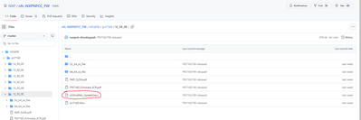

NXP offers FW update code as part of the SW6705.
All PN7160 FW versions including ".c" files are available on PN7160 Github.

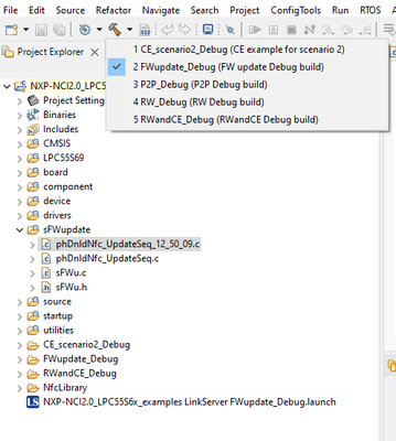

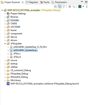

The FW source data are inside the sFWudpate folder.
  • phDnldNfc_UpdateSeq.c -> FW Version 12.50.05
  • phDnldNfc_UpdateSeq_12_50_09.c -> FW Version 12.50.09
The phDnldNfc_UpdateSeq.c is executed, which means what is inside of this "C" file is pushed to the PN7160 EEPROM.
So, if you want to update from 12.50.05 to 12.50.09.
You need to copy content from phDnldNfc_UpdateSeq_12_50_09.c to The phDnldNfc_UpdateSeq.c.
Also, make sure that the content in phDnldNfc_UpdateSeq_12_50_09.c is commended.

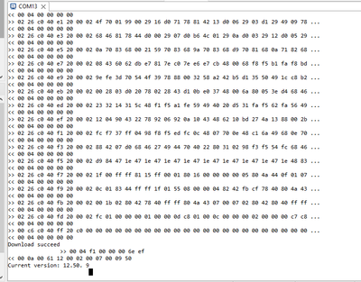

Once that's done, you can debug the code.
Then you can check the progress in "Terminal"
