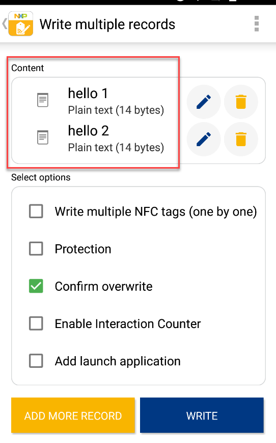

Please make sure that you have written more than on record with NXP TagWriter app.
For a more detailed explanation on this, please refer to the following document:
Writing multiple NDEF text records with TagWrite app
The app can be found and downloaded from the Play Store:
NFC TagWriter by NXP - Apps on Google Play

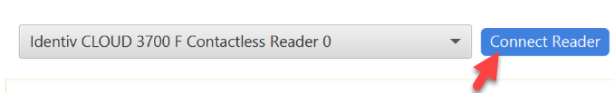

-> Connect the reader in TagXplorer
-> Place the card on the reader and press Connect Tag
-> Check for NDEF (1) and then, read NDEF (2).
