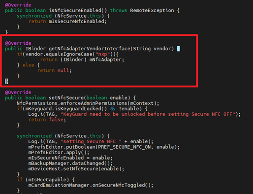

3 )   open packages/apps/Nfc/src/com/android/nfc/NfcService.java
And add this: between isNfcSecureEnabled and setNfcSecure methods:
        @Override
        public IBinder getNfcAdapterVendorInterface(String vendor) {
            if(vendor.equalsIgnoreCase("nxp")){
                    return (IBinder) mNfcAdapter;
            } else {
                   return null;
Next, follow AN13189, complete the following steps in section 4.2.
Then you can build the package successfully.  Thanks  @andraz_skupek .
