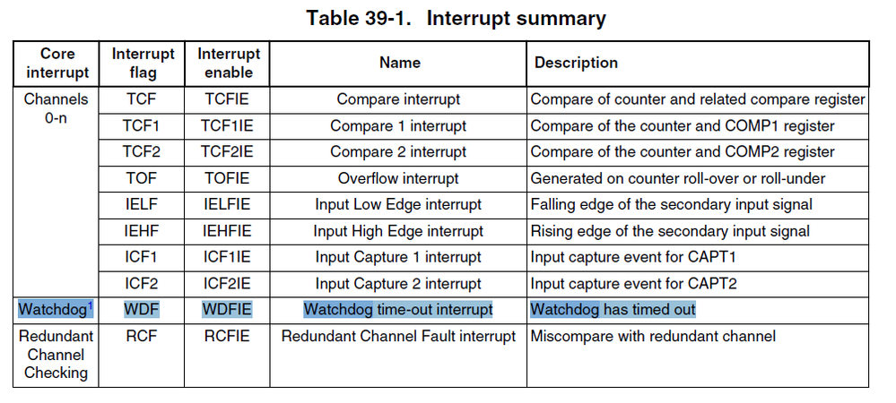

The reference manual informs that the eTimer0 supports watchdog timer by configuring the registers WDTOL and WDTOH.
I want to get the watchdog interrupt event, but I couldn't implment it using the eTimer interrupt handler as show below:

We currently do not support the Watchdog timeout-interrupt. We can consider adding support for that in a future release.
Until then, if you really need this functionality, you can achieve this with custom code insertion.
From the interrupt vector table I understand that this sis available only for Etimer 0 Channel 0 so you need to create a  custom block to implement this ETIMER0_WTIF_IRQHandler function as void function.

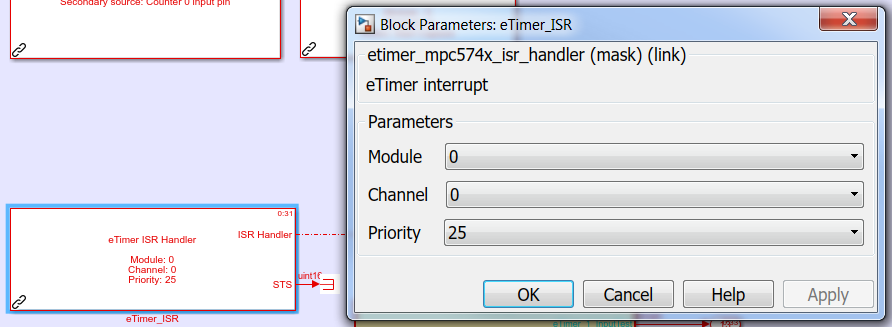

For implementing the ISR eTimer watchdog, you have two options depending on your needs:
1.  If you need to trigger a subsystem you can add an S-Function. For this you will need to attach an .tlc file. You can be inspired by our etimer_mpc574x_isr_handler.tlc. All your handler definition will be in the Start tlc. function. If you need more clarification please write me here.

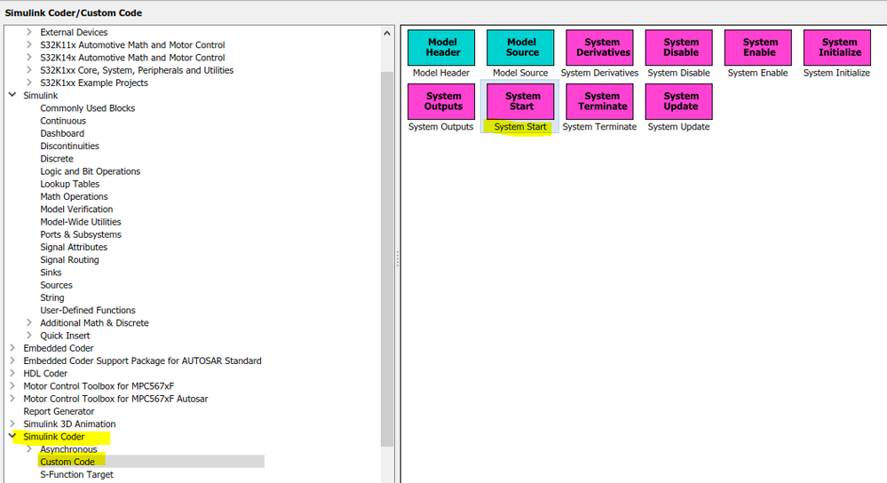

2. If you don't need to trigger a subsystem, you can simply add your code using from the Simulink Coder toolbox, the following "System Start" block. and you add your definition there.
