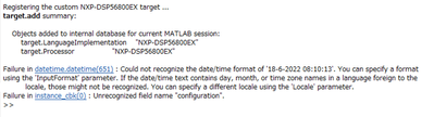

hello
When I open the DSC model, I get "datetime" and "instance" errors. Please tell me how to resolve.

Hello
Thank you for checking with various versions of matlab. The version I'm using is R2022A. Embedded Coder Support Package for ARM Cortex-M Processors is installed.
However, mbd_dsc_pth.m was not running.
Also, the date data was dd-mmm-yyyy hh: mm: ss by default in my environment.
I reviewed the advice I received and the installation folder.
1. The default installation folder Add On and a space were included, so specify a folder that does not have it and reinstall. 2. Execute mbd_dsc_pth.m. 3. Corrected the date data format mmm to mm.
Even if I did these things, I got an error in the model saved before modification, but when I opened the sample model again, it became normal.
Thank you for solving the problem.

Hello, @hayaoki7
Which MATLAB version are you using? I try to replicate your problem on MATLBA R2022a and I did not find any problems. Also, do you have installed Embedded Coder Support Package for ARM Cortex-M Processors? Did you run the mbd_dsc_path.m script?
You could try to run the following command in the MATLAB Command window to change the date and time format: datetime.setDefaultFormats('reset') - this will reset date and time format to default factory formats or datetime.setDefaultFormats('default', 'dd-MM-yyyy hh:mm:ss') - this will set another time and date format specified as the second parameter.
Stefan.
