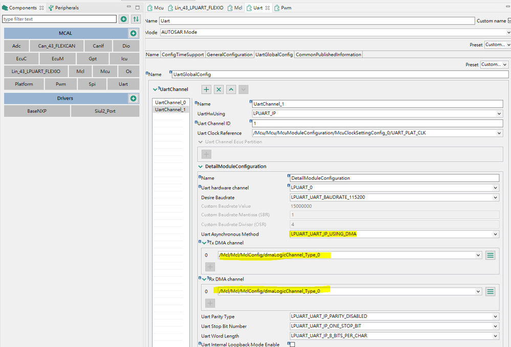

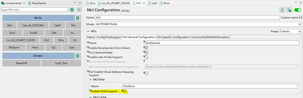

I referred to the link and configured these in my S32 config tool, but I can't tell if this is correct for the UART DMA configuration.
1. MCU-> MCL General Congiuration -> Enable DMA
2. MCU-> MCL Specific Congiuration -> Dma Logic Instance
3. MCU-> MCL Specific Congiuration -> Dma Logic Channel
4. Uart-> General Congiuration -> Uart DMA Enable
5. Uart-> UartGlobal Config -> Tx DMA channel & Rx DMA channel config

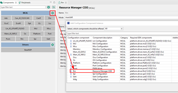

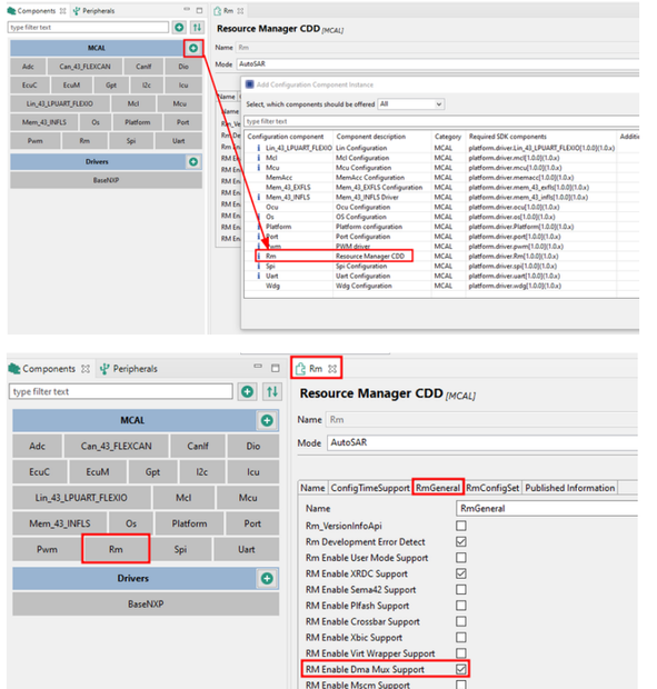

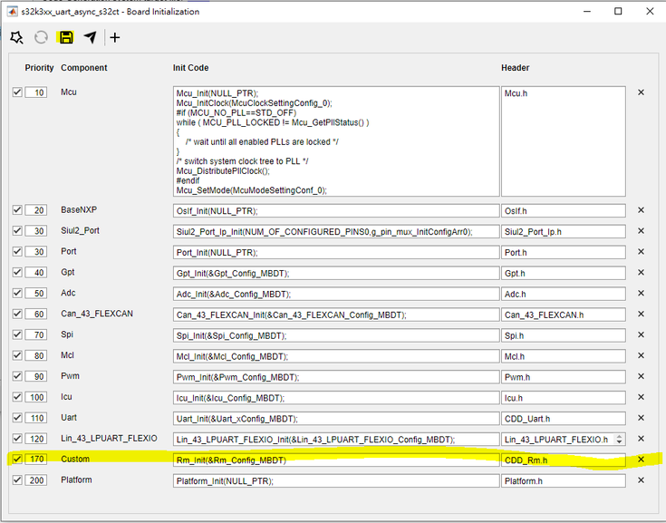

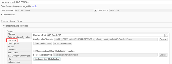

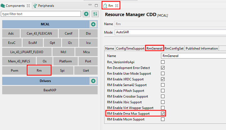

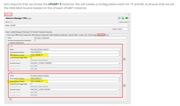

1. RM tab

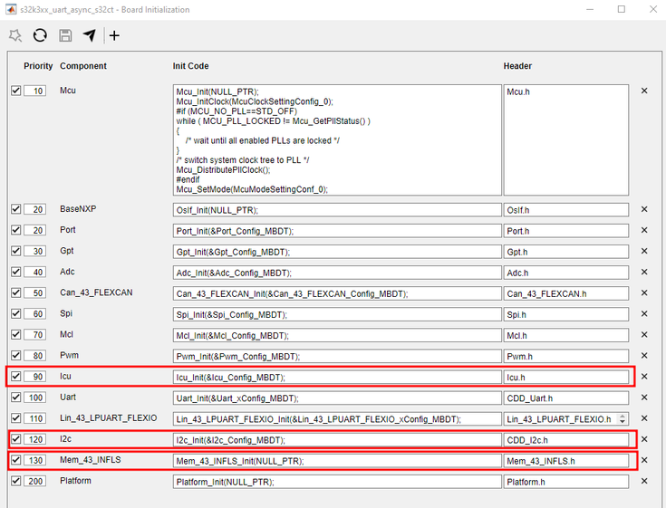

In order to implement a DMA transfer, it will be necessary to add the RM (Resource Manager) component, to be able to set the DMA source.
Let's assume that we chose the LPUART 3 instance. We will create a configuration each for TX and RX, to ensure that we set the DMA MUX Source based on the chosen LPUART instance.

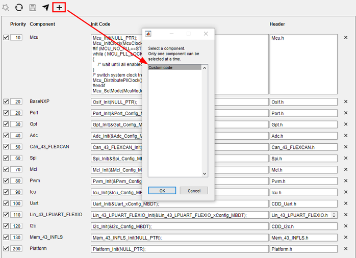

It should be noted that this newly added Rm component must be initialized in the Board initialization.

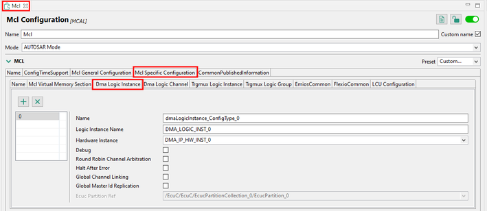

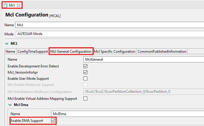

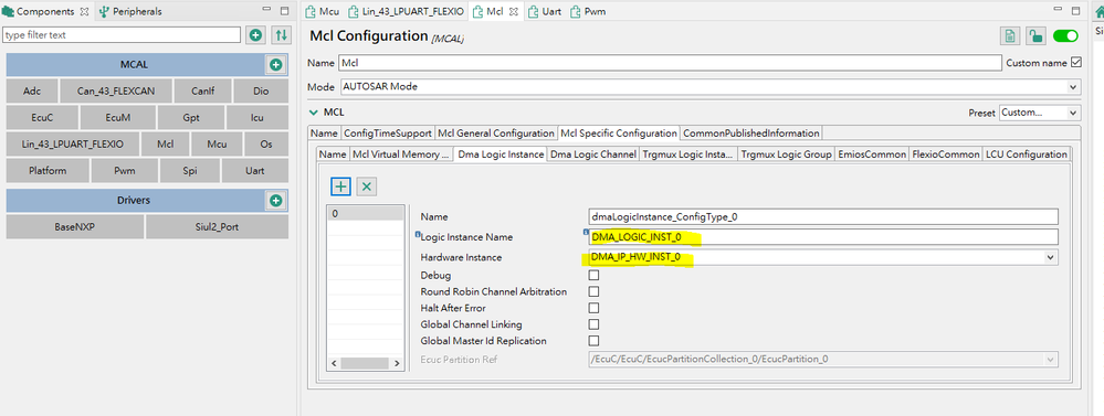

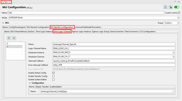

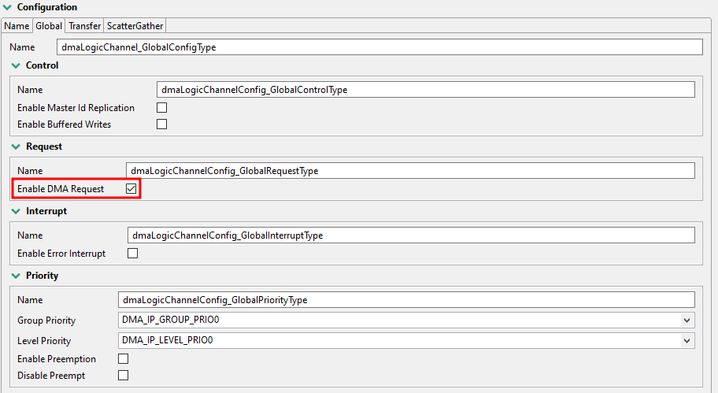

2. MCL tab
The MclDma must be enabled.

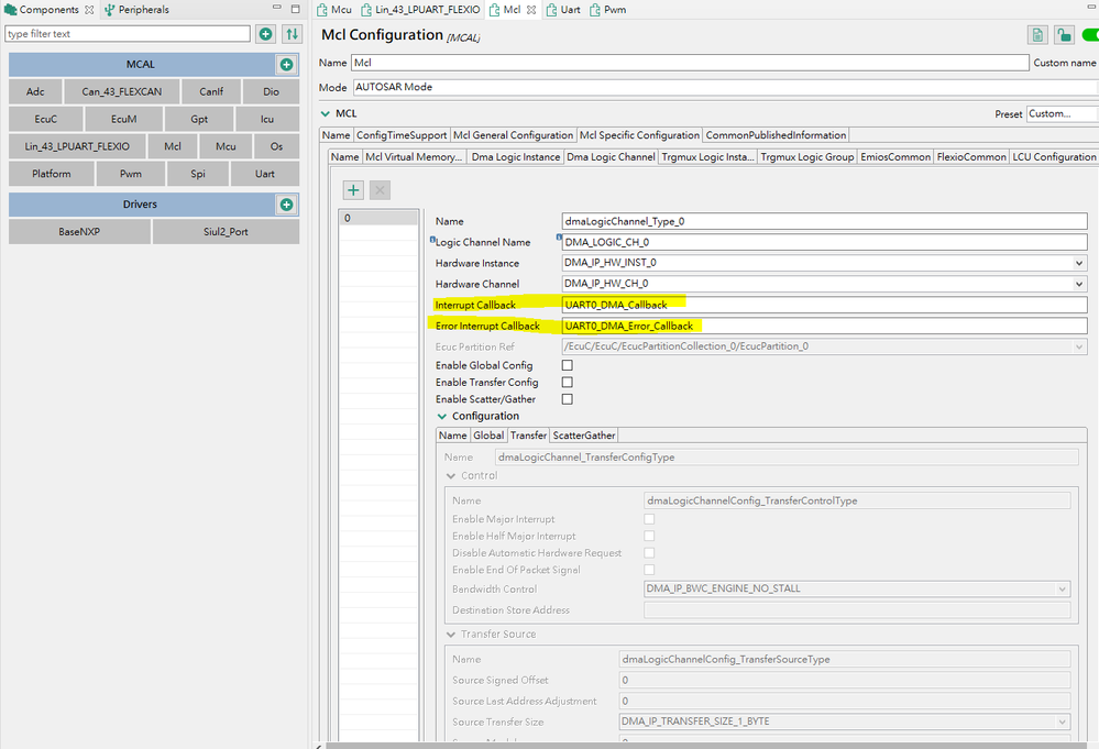

A logic instance must be assigned.

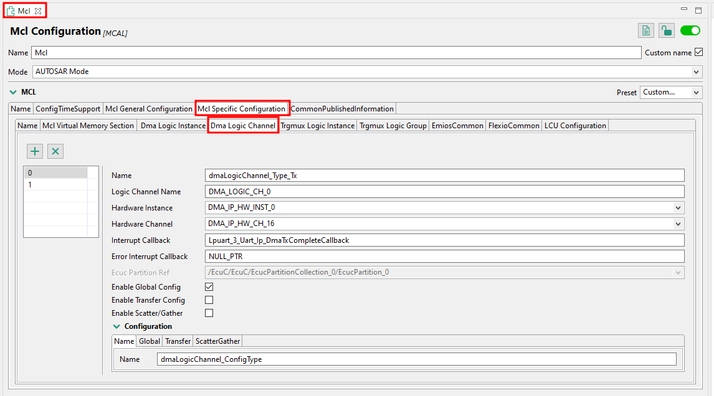

And the logic channels must be set, for both TX and RX.
The Hardware Channel must be the same as the one set in the Rm component, at Dma Hardware Channel (DMA_CHANNEL_16 and DMA_CHANNEL_17).
For UART using DMA, the interrupt callbacks are already defined based on the LPUART instance, so in this case must be used Lpuart_3_Uart_Ip_DmaTxCompleteCallback and Lpuart_3_Uart_Ip_DmaRxCompleteCallback.
The Enable Global Config check enabled the Global tab usage, where it should be enabled the DMA Request.

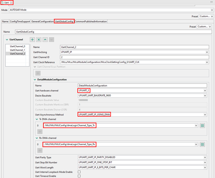

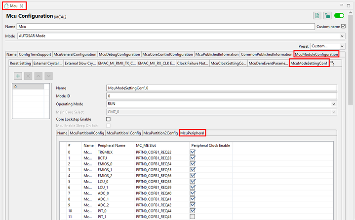

3. MCU tab
The corresponding peripheral clocks must be enabled.

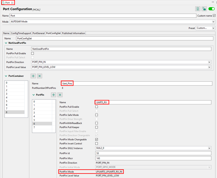

4. PORT tab
The RX and TX pins must be enabled for the LPUART 3 instance.
dragostoma_17-1726647268934.pngdragostoma_17-1726647268934.pngdragostoma_18-1726647300601.pngdragostoma_18-1726647300601.png

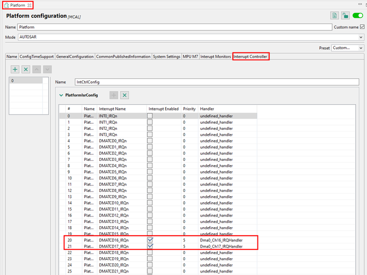

5. PLATFORM tab
The corresponding interrupts must be enabled.
It should be mentioned that the interrupt corresponding to LPUART 3 should not be enabled, because the data transfer will be done through DMA, and the interrupts will be triggered based on the chosen TCDs and RX and TX callbacks.

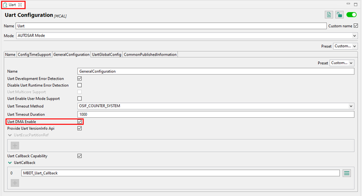

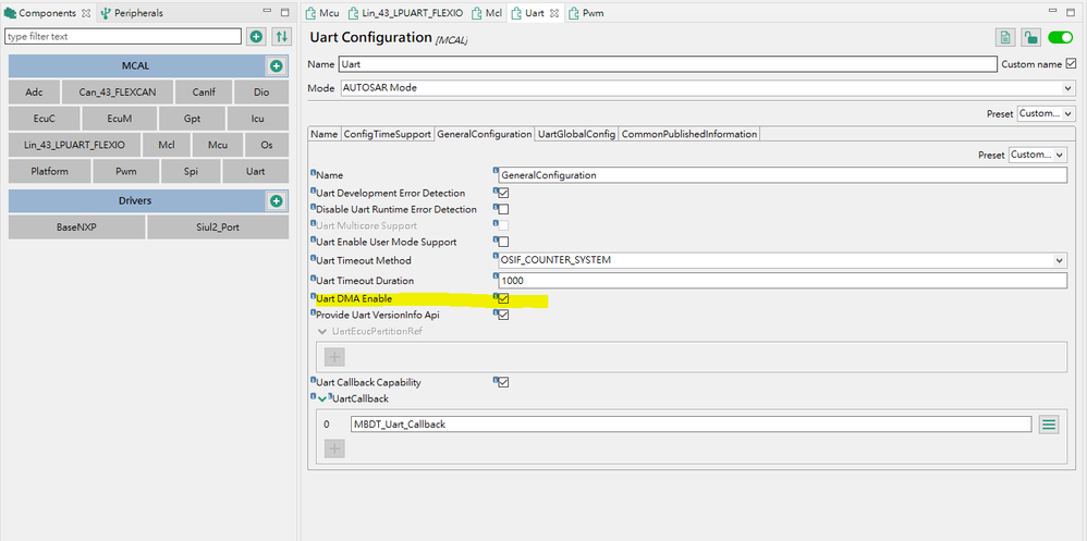

6. UART tab
The DMA must be enabled.
You should check also the Uart Timeout Duration according to your application.
It should be mentioned that for this demonstration we chose LPUART 3 arbitrarily, and that any other instance can be used. Keep in mind that a USB2Serial Converter is needed for this instance, because the RX and TX pins are not directly connected to OpenSDA, as in the case of LPUART 6. If you want to use LPUART 6, the UBS2Serial Converter is no longer needed.

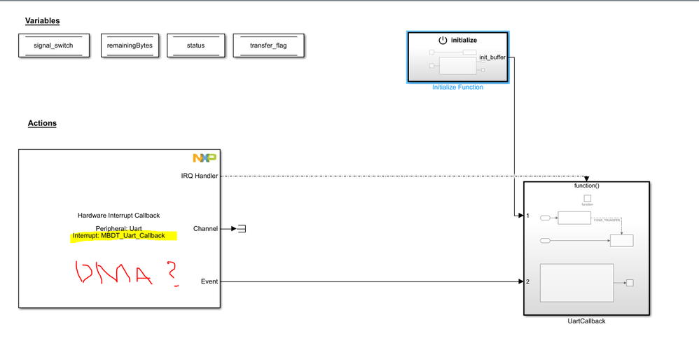

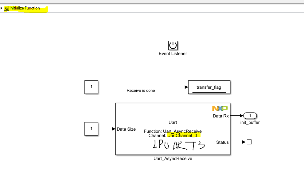

You can use the Simulink model from the Async UART example and it should work correctly for the previously configured LPUART instance. For the Hardware Interrupt Callback part, the model will use the same UART callback that will manage the data transfer through DMA.

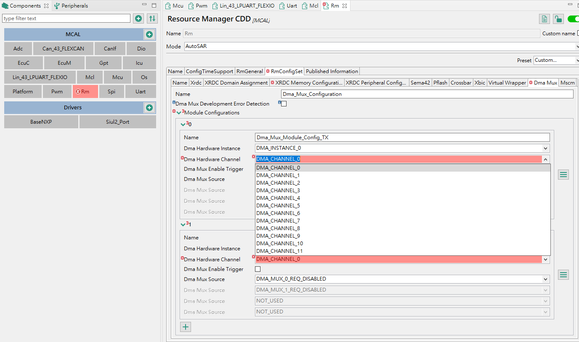

I have a question during the setting process, which is about the setting of DMA Hardware Channel.
Referring to the picture you provided, you selected ch16 and ch17.
But I don't see the channel in the s32config tool.
I'm worried that this channel setting will be related to the selected uart, but I didn't see the relevant guidance in the user manual.
Do you have any suggestions?

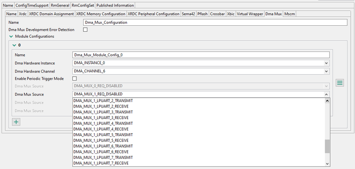

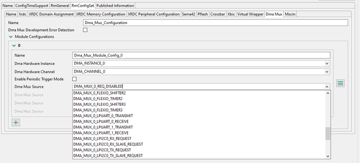

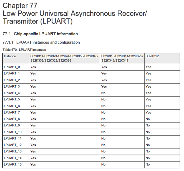

The reason why the number of channels differs is because in my example I used a different hardware board, namely S32K344. The number of channels differs depending on each hardware board. I chose to use in the presented example an instance and some arbitrarily chosen DMA channels, just for demonstration purposes, but you can choose any instance available on the hardware board you own.
Dma Hardware Instances are divided so that either Dma Mux Source 0 or Dma Mux Source 1 can be used. In the example shown, Dma Mux Source 1 is used. You can also use the same source, choosing hardware channels from the second half of the list .
The LPUART instances available for each individual source differ and depending on your application and the availability of the LPUART instances, you can choose Dma Mux Source accordingly:
DMA MUX 0: LPUART_0, LPUART_1
DMA MUX 1: LPUART_2, LPUART_3, LPUART_4, LPUART_5, LPUART_6, LPUART_7
Whichever instance and channels you choose, make sure you maintain consistency with regards to the DMA configuration.

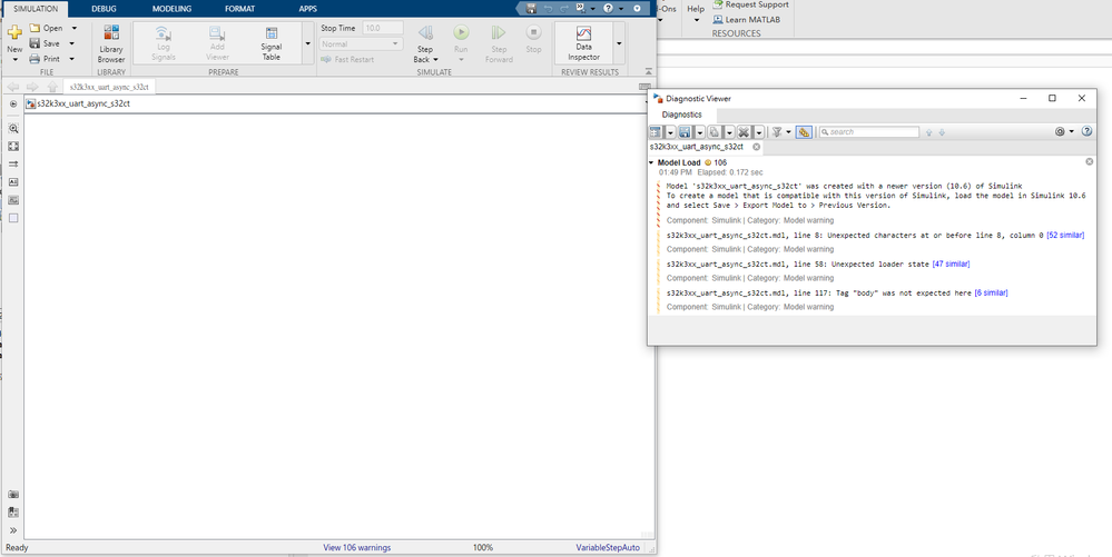

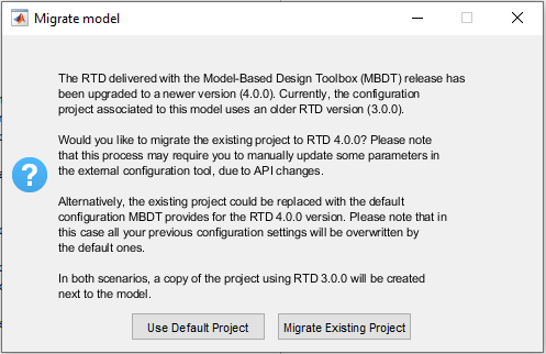

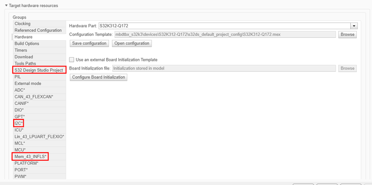

I followed your instructions and tried to configure DMA, but was unable to refresh the program.
It always show this error message.
Currently, I am using the sample project "s32k3xx_uart_buffer_s32ct" to try to set up the DMA of LPUART 3.

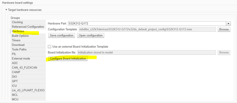

I found that just adding "Rm_tab" in the S32 configuration tool and updating the code caused the error to occur.
Although I did not configure anything in Rm_tab and Borad was not initialized when it was initialized, the above error message popped up immediately.
Of course, this also happens if I follow the Borad initialization steps you provided.
Can you give me some advice?

I saw you mentioned "You can use the Simulink model from theAsync UARTexample and it should work correctly for the previously configured LPUART instance. For the Hardware Interrupt Callback part, the model will use the same UART callback that will manage the data transfer through DMA."
Do you mean that I just follow the Example project to complete the block configuration?
For example, enable the uart channel of lpuart 3 in the initialize function.
Than, change all uart channels to lpuart 3. I can implement DMA.
Is this your meaning?

First of all, I would recommend that you initially configure the application using the s32k3xx_uart_async_s32ct model, being simpler, transferring a single character, compared to the model you mentioned s32k3xx_uart_buffer_s32ct, which uses a buffer with which you can transmit several characters.
Secondly, related to the error that mentions that there are two files with the same filename in the list of source files, I recommend you try to delete the files generated next to the model, namely the model_name_Config folder and try to open and build from new model. Also, make sure that you don't have multiple Config folders generated in different locations in the toolbox, because they may interfere with each other. If the error persists during the build, your model and configuration could help us to try to figure out the problem.
Moreover, related to the activation of the RM component, I do not understand exactly how you achieved the enablement of this component, try to follow the described steps and configure in the RM component to be able to use the DMA functionality.
Related to your final question, if you select in the Simulink blocks the UART channel corresponding to the instance that is configured to use DMA, and if you correctly followed all the steps previously described, you should have an application that successfully transmits using DMA. In the Hardware Interrupt Callback block, MBDT_Uart_Callback must be enabled, for this it calls the interrupt callbacks configured for TX and RX.

Dear @dragostoma @Irina_Costachescu,
Can you help me resolve the above error message - "Build process stopped because two files have the same filename in the list of source files" and the above questions about UART DMA in MBDT config?

dragostoma
Hi, @SuperBeginner,
I downloaded your archive and tried to open the model. First of all, I notice that you mention that you are using toolbox version 1.5.0 which uses RTD version 4.0.0 P19. When I try to open the model, the model migration pop-up appears, notifying me that the version of RTD has changed from 3.0.0 (corresponding to toolbox version 1.4.0) to 4.0.0 (corresponding to the latest version of toolbox, 1.5.0).
This indicates that there is a problem somewhere and you are actually using an earlier version of the toolbox. As I mentioned before, various problems can arise from here if the toolbox versions interfere with each other.
The same thing can be seen from the settings you are trying to configure in Hardware Settings, which denotes the use of a previous toolbox version (1.4.0
- your settings:
- the 1.5.0 toolbox settings:
- your settings:
- your settings:
So, the general idea and the conclusion we can draw is that you are actually using an older version of the toolbox, which can cause the problems you encounter. Or if that's what you want, to use version 1.4.0, that's what you have to mention, just like the version of MATLAB you're using and that caused us problems in previous threads. It is important to mention because the workflows differ according to each version. The steps I presented are for the latest version of toolbox, 1.5.0.
Let us know about the progress made.
Dragos

dragostoma
Hi, @SuperBeginner,
Each version of the toolbox has its own peculiarities, with possible major changes to the workflow or configuration of the settings. A new toolbox version not only means different functions in Simulink blocks, but different versions of tools, such as S32 Configuration Tools, which can change the way some settings are configured. For example, a major difference between toolbox versions 1.4.0 and 1.5.0 is the way the pins are configured in the S32 Configuration Tools. I recommend this thread to understand the peculiarities and differences compared to version 1.4.0 that you are currently using.
In the steps I detailed for you regarding the DMA configuration, I used the latest version, i.e. 1.5.0, where the Port component is used. In the previous version, 1.4.0, the approach was different, the pins were configured directly in the Pins tool, the Port component was not needed, but the Siul2_Port component was needed instead. The fact that you also enabled the Port component led to the problems you encountered when trying to configure your application.
I recommend that in the future you specify more exactly which versions you are trying to use, because this way we will get to solving the problems much faster.
I leave attached the version of your model that can be built, with the changes mentioned above, that is, the deletion of the Port component and its initialization from the board init.
I hope that now you can successfully configure your application.

In addition, regarding DMA configuration issues, I can't open the model you provided.
It always shows this error message.
However, I followed your instructions to configure the S32 Config Tool, that is, the deletion of the Port component and its initialization from the board init.
I can successfully building the program to s32k312evb-q172.
Than, I used the USB2Seraial Converter and connected it to the TX and RX pins on the board.
That is, USB_Converter_TX is connected to PTE15 PIN (J3.21), USB_Converter_RX is connected to PTE15 PIN (J3.18), USB_Converter_GND is connected to GND (J39.19).
After establishing these connections, I communicated using the serial communication tool (for example PuTTY), but the UART communication failed.
No characters from LPUART 3 will appear in my monitor window.
I've attached my program here, could you figure out the problem, please?
Thanks in advance
