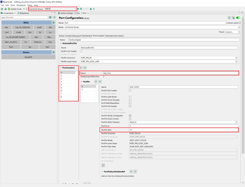

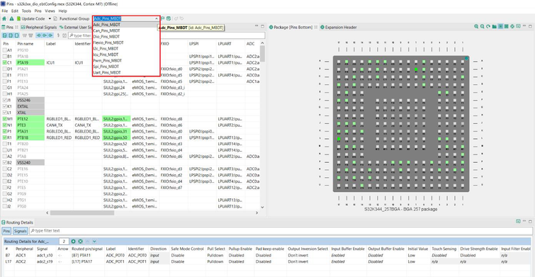

The toolbox offers support for configuring the on-board pins using the Port component, from the Peripherals Tool, together with the Pins Tool. The two must be used together as required by the implementation of the RTD (Real-Time Drivers) package that MBDT integrates. The configuration of the pins must be made according to the following information:
For each functional group inside the Pins Tool, a Port container must be configured inside the Port component. Please see the screenshots below, the first one taken from the Pins Tool, and the second one from the Port component configuration inside the Peripherals Tool of a .mex file.
By inserting the PortPin Mscr inside the PortPin configuration, the settings inside the Port component for that particular pin will be automatically populated as configured inside the Pins Tool. The name of the Pins Tool functional group must respect the following convention: PortContainer Name + ‘_MBDT’, ‘MBDT’ representing the name of the Functional Group from the Peripherals Tool, where all the components of the project are configured.
Please check one of the default configurations provided inside the toolbox for an example on how Port and Pins must be configured.

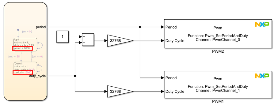

We have an additional problem that is that PWM periode is not updated. All PWM outputs are frozen to the default DT configured in the ConfigTool.
We are unsing EMIOS0 channels 1 and 2.
Do you have any idea on this subject.

Now related to the problem with the PWM period, in the toolbox there is a model that addresses the modification of both the Duty Cycle and the Period: s32k344_pwm_independent_ebt.
The model has 2 PWM channels with a variable Duty Cycle and Period:
The results will look like this:

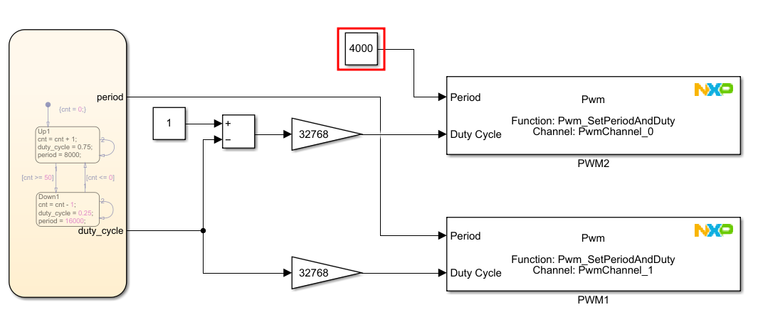

But when you change the Period of the PwmChannel_0 to 4000, as in the following picture:
By changing the value of the period in the second case, the signal parameters change can be observed. Following the example of this model, you can change the period of the signals configured in your application.
I recommend you to try this approach of using the period change of a PWM signal. Let us know if there are any problems.
