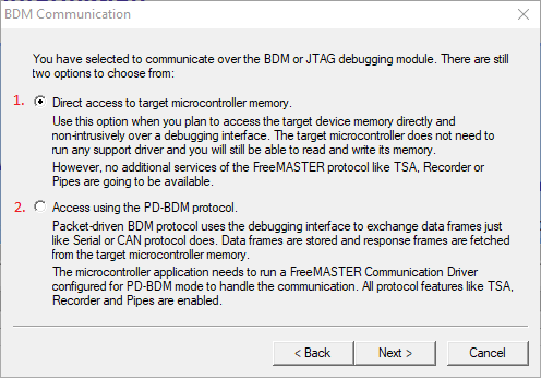

First thing to note when working with FreeMASTER BDM Plugin is that there are 2 modes:
  1. Direct access to target microcontroller memory - the "traditional" or non-intrusive debug mode. In this mode you don't need FreeMASTER support to be enabled on the target as it relies on the hardware debug mechanism, however you won't have access to FreeMASTER specific features such as TSA, Recorder or Pipes.
  2. PD or Packed-Driven BDM that uses the debug register to exchange data frames just like UART or CAN protocols. This mode requires FreeMASTER Driver enablement, which, as far as I know is not supported by the MatLAB Toolbox. You'd need to go into freemaster_cfg.h file and enable it:

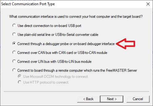

To make sure you don't confuse these 2 modes, I suggest using Connection Wizard:
In the next step it is configured just like Marius did.

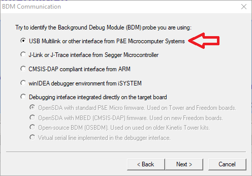

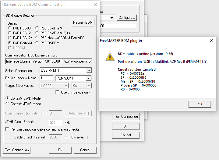

I tried going in the Options to the Comm options and selected in the Plug-In module the first option "FreeMASTER BDM Communication Plug-In"
Now, by pressing the Configure button, the following Window appears. Here I selected the P&E CortexM and selected the connection to USB Multilink. The only speed required here is the JTAG Clock Speed.
Using this setup, I was able to connect to the board even if the FreeMaster Config block is in the model so no changes had to be made in the model.

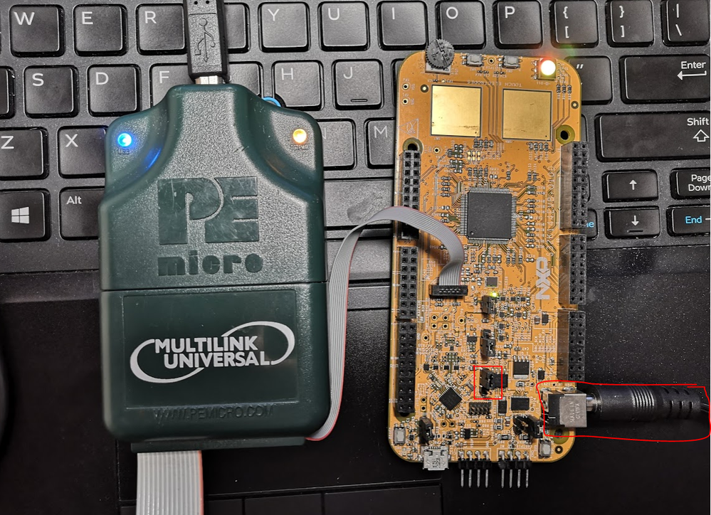

Instead of USB Multilink, you can select also the OpenSDA which comes directly on the S32K144 EVB but, if you are using the PEMicro, I suggest to power up the board externally in order to disconnect the OpenSDA from the circuit ( cheange the J107 to other position and unplug the USB cable). If not, then there will be two debuggers (Multilink and OpenSDA on the same JTAG link to the controller).

iulian_stan

你好我这边用的S32K344 Q172 EVB ,然后尝试用direct Access 的方式连接了,根据描述EVB这边是不需要 FreeMaster 的驱动支持的。但是我这边testConnection 一直是灰色。这边有什么好的建议吗?

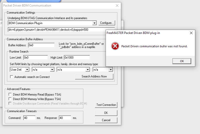

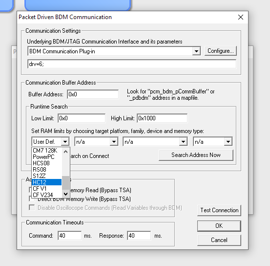

When I go into the PD-BDM configure window, the S32K does not appear in the dropdown box:
If I go into Configure and Test Connection:
It looks like all is good? But when I go pack to the main configuration screen and Test Connection I get this:
9,669 Views

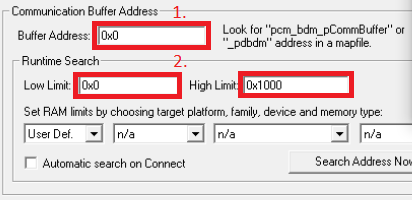

You are almost there, the missing piece is the communication buffer address. You can either specify:
  1. its exact address or
  2. a range to scan
You could get the exact address from the map file. The line would look like this:
.bss.pcm_bdm_pCommBuffer 0x20004c64 0x44 ./FreeMASTER/src_common/freemaster_bdm.o
Or specify the range. Considering you cannot predict the exact location where that buffer will be stored you'd need to specify the entire RAM range.

iulian_stan
To clarify - the thing I mentioned above, currently won't work with MatLAB toolbox. I just checked with mariuslucianandrei‌ and found out that the toolbox does not even include freemaster_bdm sources that would be compiled into that object file. So simply modifying that flag won't do the work, or to be precise - it won't compile due to missing source files. The process of enableing this functionality starting from the MatLAB/Simulink project at this point would be quite complicated:
1. Import the project into an external IDE
2. Add missing source files from FreeMASTER Driver
3. Adjust configuration options
Needless to say it will completely break the compatibility with the MatLAB/Simulink project.
At this point, a "workable" option is the one shown by Marius (standard BDM with limited FreeMASTER features).
I would let someone from the MBDT team comment in case there are any plans to add PD-BDM support to the MatLAB toolbox.
